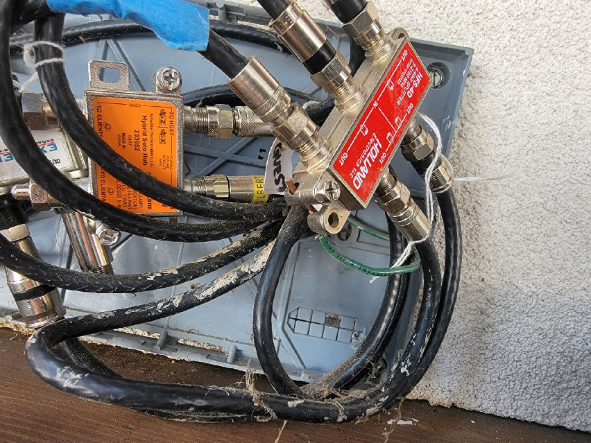

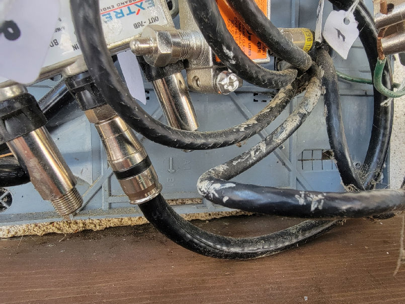

I noticed a quiet buzz coming from the speakers, so I pulled the coax connection from the Hopper and the buzz was gone. (I had a problem restoring the Hopper picture. I had to reboot several times due to the blue screen of death but I got it going again.) The buzz was still present after resetting, but it was quieter than before. Outside at the junction box, I noticed a green, 14 ga, wire attached to one of the DIsh signal splitters. I don't know where the grounding wire is coming from though.
Where is the other end of ground wire attached? And there should be a second black wire attached as well that comes from the cable going to the dish, with it also attached to the mount for the dish. Could you take a few pictures?
Couple of pictures attached. The first picture shows the ground cable attached to thew splitter. It disappears into the wall, and probably snakes under the house. On the 2nd picture, the large cable to the bottom left comes from the dish itself. I don't see any "second black wire" attached to the incoming cable nor do I see any type of grounding cable at the satellite dish. Thanks for your input.
