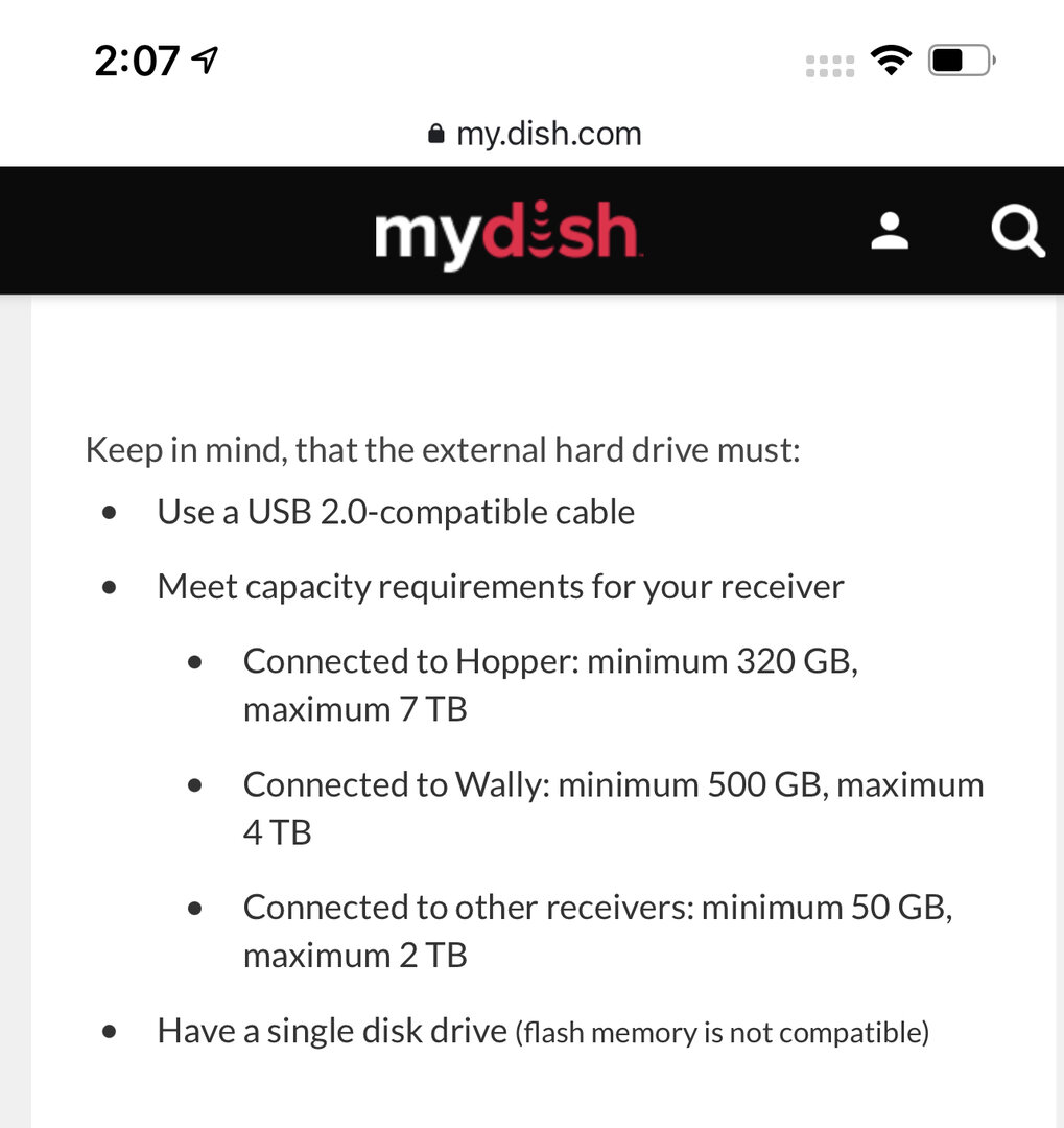

While I know we are taking about a Hopper, I’m just going to post this so that people on a VIP/Wally are aware
What do they mean "flash memory is not compatible"? I haven't tried this recently. But when I did, a bus-powered SSD drive worked well on a 612.
Reactions: ethanlerma
I’ve also tried an SSD and it works fine (On the H1 however, haven’t tried recently), I believe they say that so that people don’t use them on Wally/211 receivers, because those specifically use the EHD for guide and live tv buffering, and that will wreck your flash memory sooner then later.
If you are just archiving a DVR I don’t see the issue.

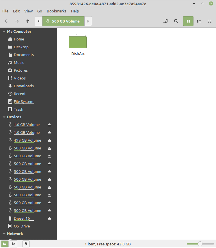

I now have both EHDs attached and ready for the transfer. What I see on the tree in file manager under devices is two 1.0 GB Vols, one 499 GB Vol, and nine 500 GB Vols. I identified the first 1.0 and the 499 and the next three 500s as the 2TB donor drive, and the next 1.0 and the remaining six 500s as the 3TB target drive.
In the folders on the donor drive, it looks like the top one labeled 499 GB Vol is full, the next one is 2/3 full, and the next two are full. The next six 500 GB Vol, all on the target drive are each empty. When I mount a different 3TB drive which is about 80% full, the bottom six folders (on the attached image), there does not seem to be a similar pattern. The top one is empty, next one ½ full, and the rest are all full.
Does it matter which folder I put the copied files in? Do I follow the same pattern and fill the folders from the bottom up? I anticipate filling the bottom folder from the donor drive to the bottom folder on the target drive, and work my way up from there.
Why is the one folder on the donor drive labeled 499, and all the rest are 500? Do I just put the files from the 499 folder into a 500 folder?
I did as you suggested, I filled from the bottom up and checking to make sure that each recording would fit as they can't span a volume. The Hopper does that same thing, it fills backwards from the bottom up to cluster recordings together and minimize disk seeks. But to your base question, it doesn't really matter where you place an individual recordings folder and you can put it in any of the 500 gig volumes.
As for the 499, the reason it's 499 is that you probably started with a real 500 gig hard drive. The Hopper would have liked to allocated 500 gig but it needs a gig for the VTOC (Volume Table Of Contents). So each physical drive has a 1 gig partition at the beginning and the rest is formatted as data.
