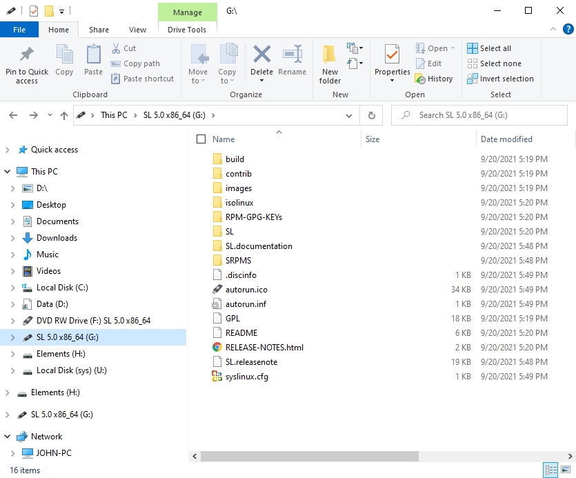

My memory isn't good enough to interpret this screen grab. Is this the SL file manager? It looks like the contents of your boot CD. If so, you need to plug in your EHDs and let it auto-mount them. Each partition will appear as a separate ext3 disk, and you can start dragging and dropping program folders from one disk to another.

In the beginning, I used Cinnamon and it worked well. After downloading the iso I made a USB boot drive, and also made a DVD boot disk, both by using Rufus. The screenshot shows the structure of the USB drive, and the DVD looks the same. Their sizes are the same. Is there any flaw that anyone can see?
I put the USB drive into the Toshiba P770 laptop, (of which I own 5) and started the machine. No other drives or media were mounted. I started the machine loading process using the USB. It asked me to select languages and keyboard, and then asked for the location of the media. I was using the USB, but somehow It did not offer a USB option for loading files, so I put the boot CD in the drive, and it kicked it back out at me in a fit of disgust.

Well, nuts. :crying I vaguely remember having that issue once. But I no longer remember how I overcame it. Do your Toshibas have BIOS or UEFI? If UEFI, are the "legacy" settings enabled? I do remember booting up Linux to erase the hdd on brand new computers, because I couldn't boot up a Windows 7 installation thumb drive; it kept going to the hdd instead or not showing me the USB drive at all.
You might have to step up to SL6 or 7 if you can't figure out what the issue is.
Was gonna say, it could also be that the thumb drive was formatted in GPT/UEFI with the laptop only being MBR/BIOS compatible, I've forgotten to check that in Rufus before.
