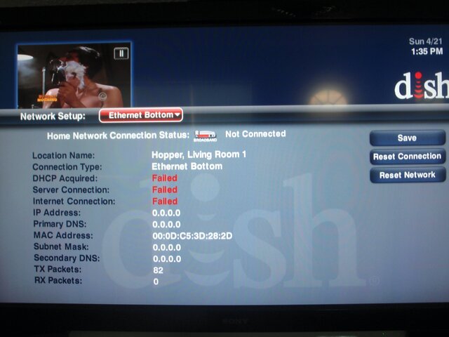

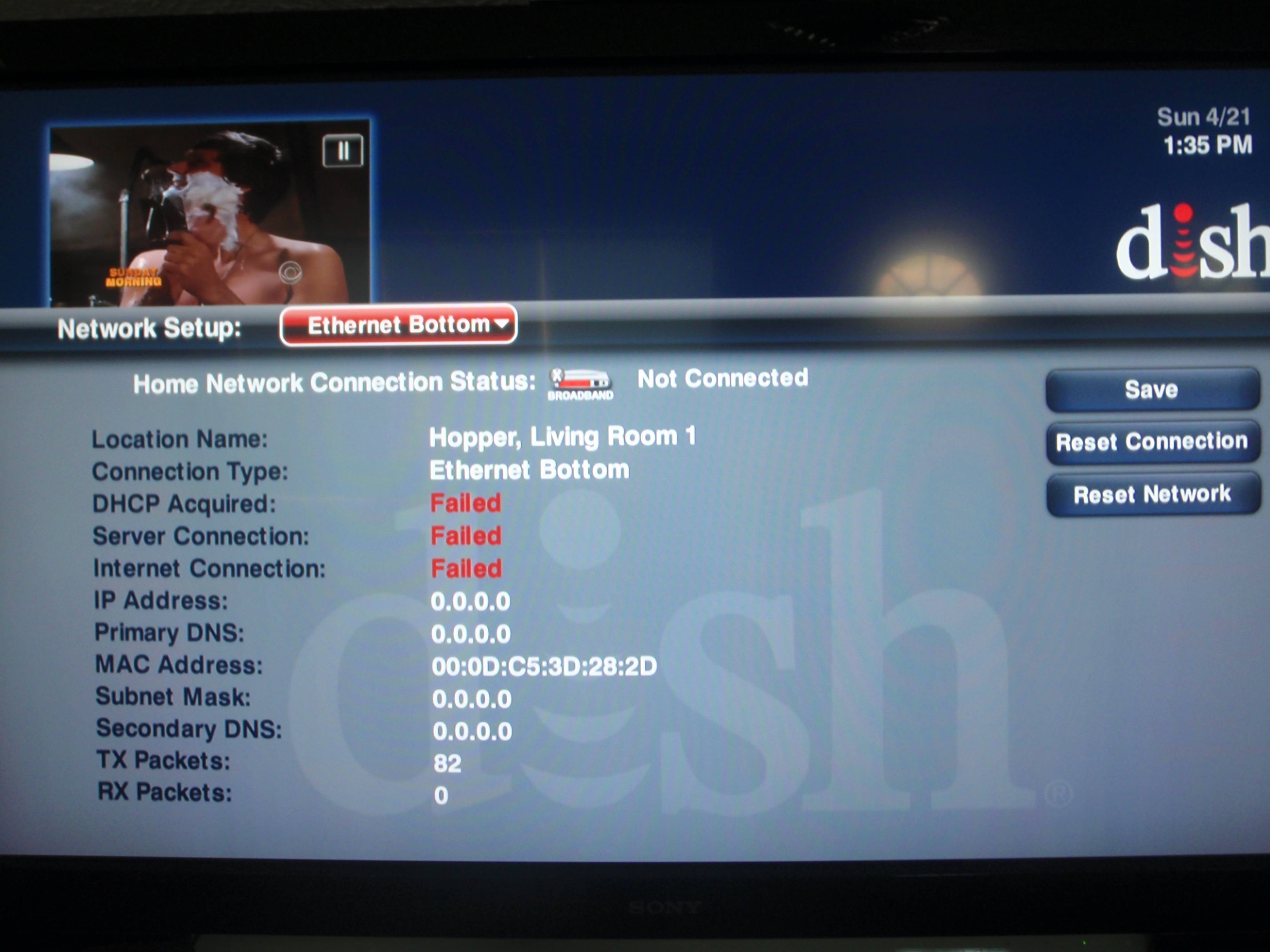

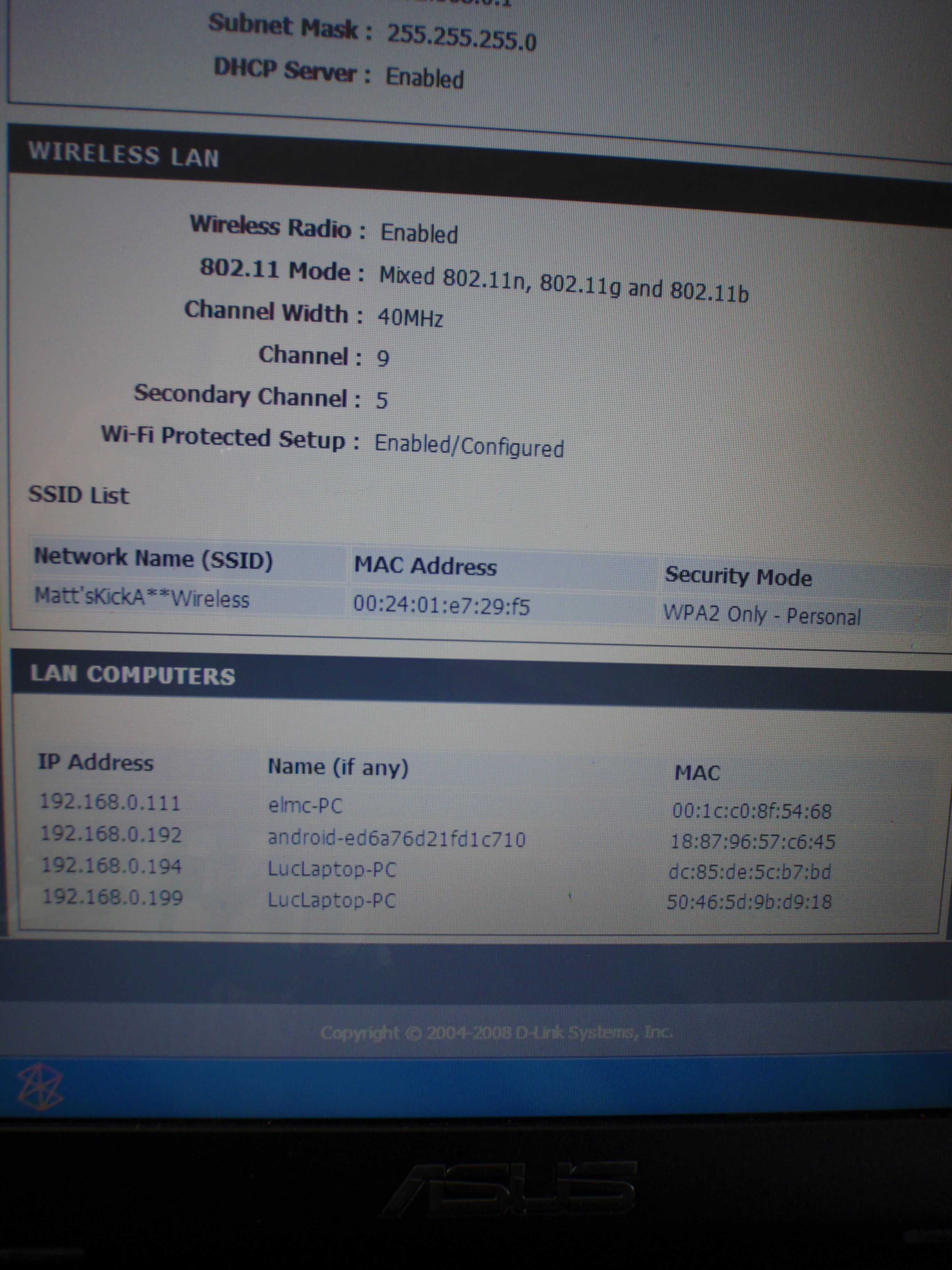

Here in pic 1 you can see my hopper broadband setting page.

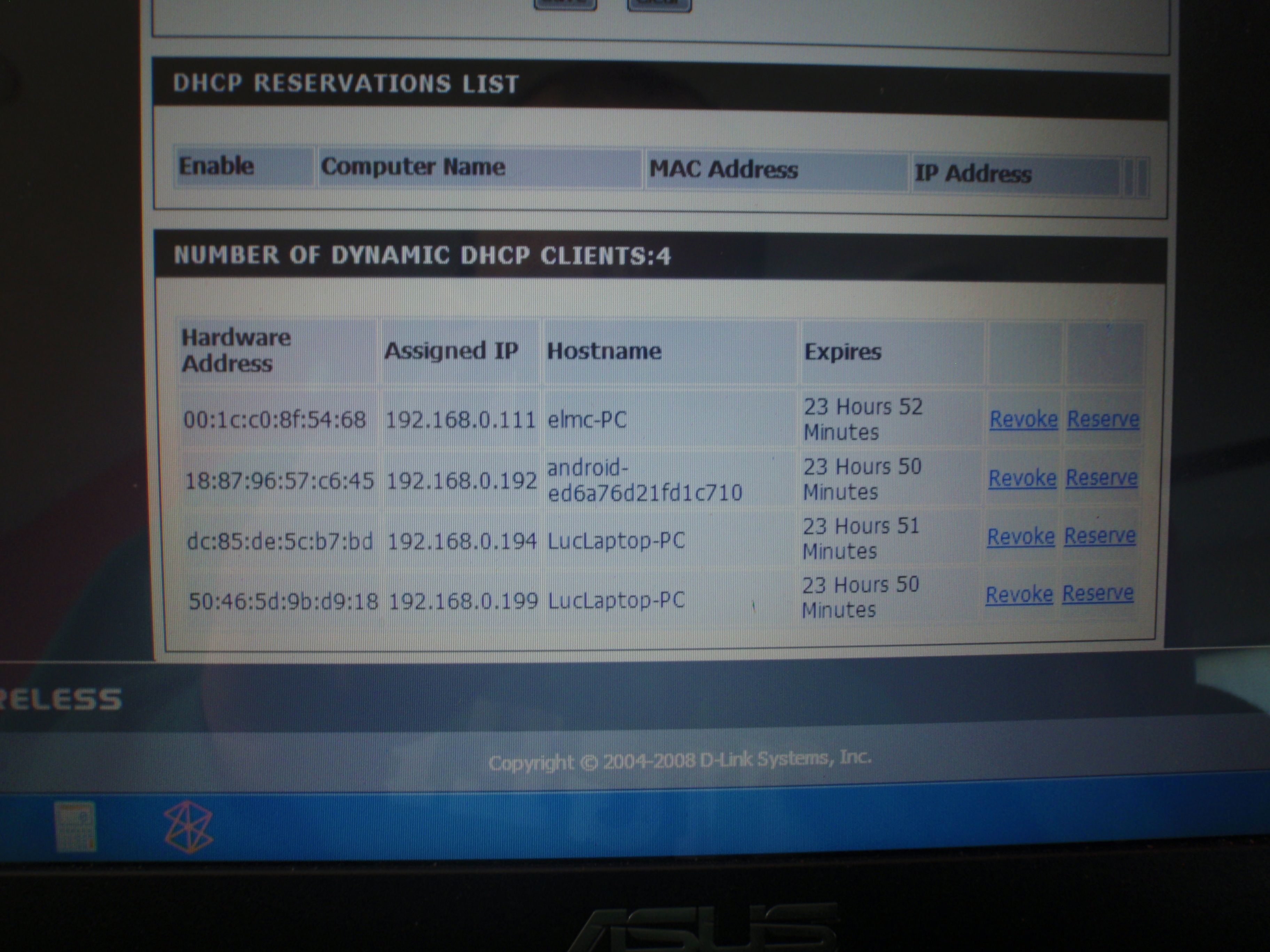

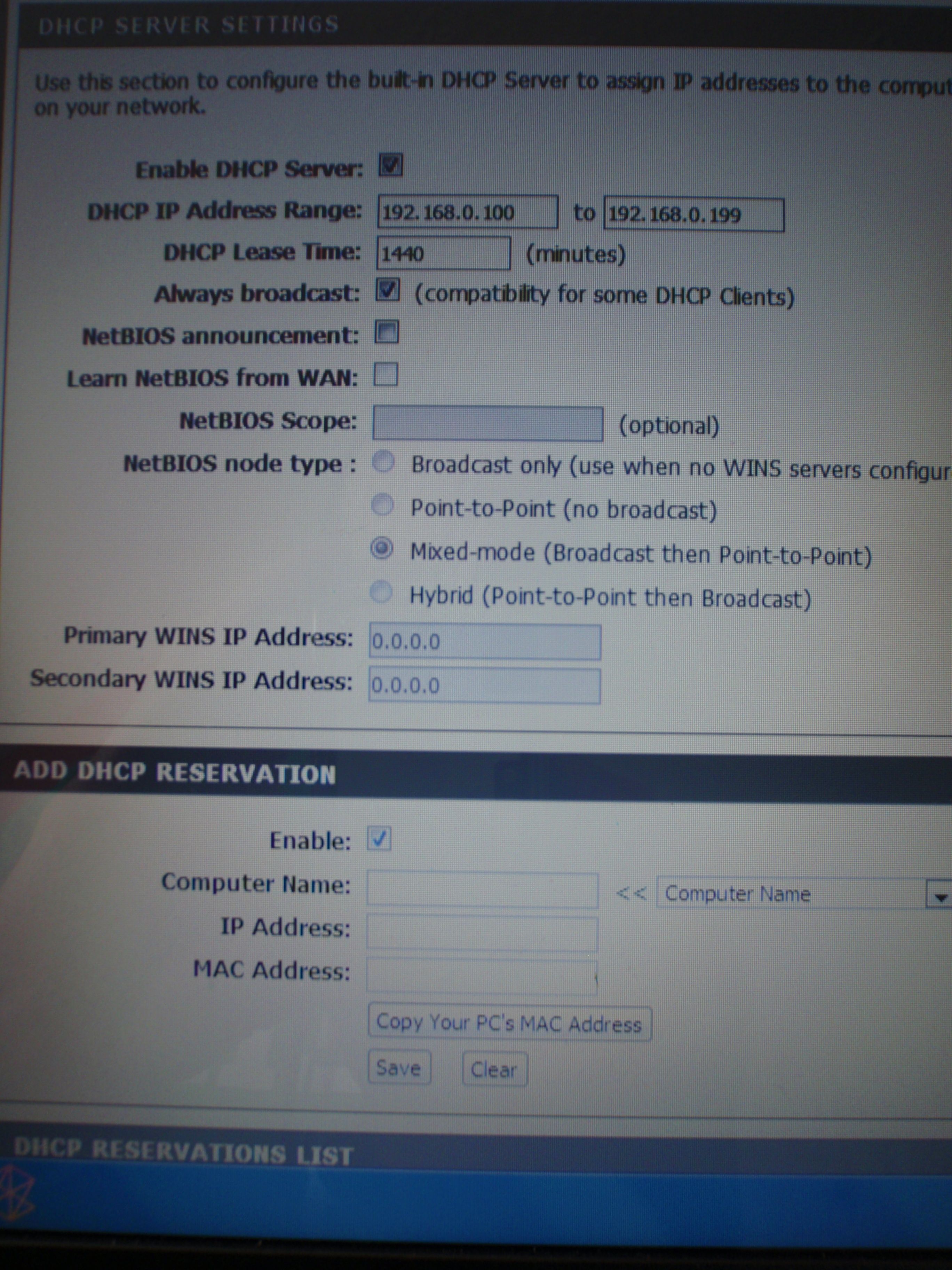

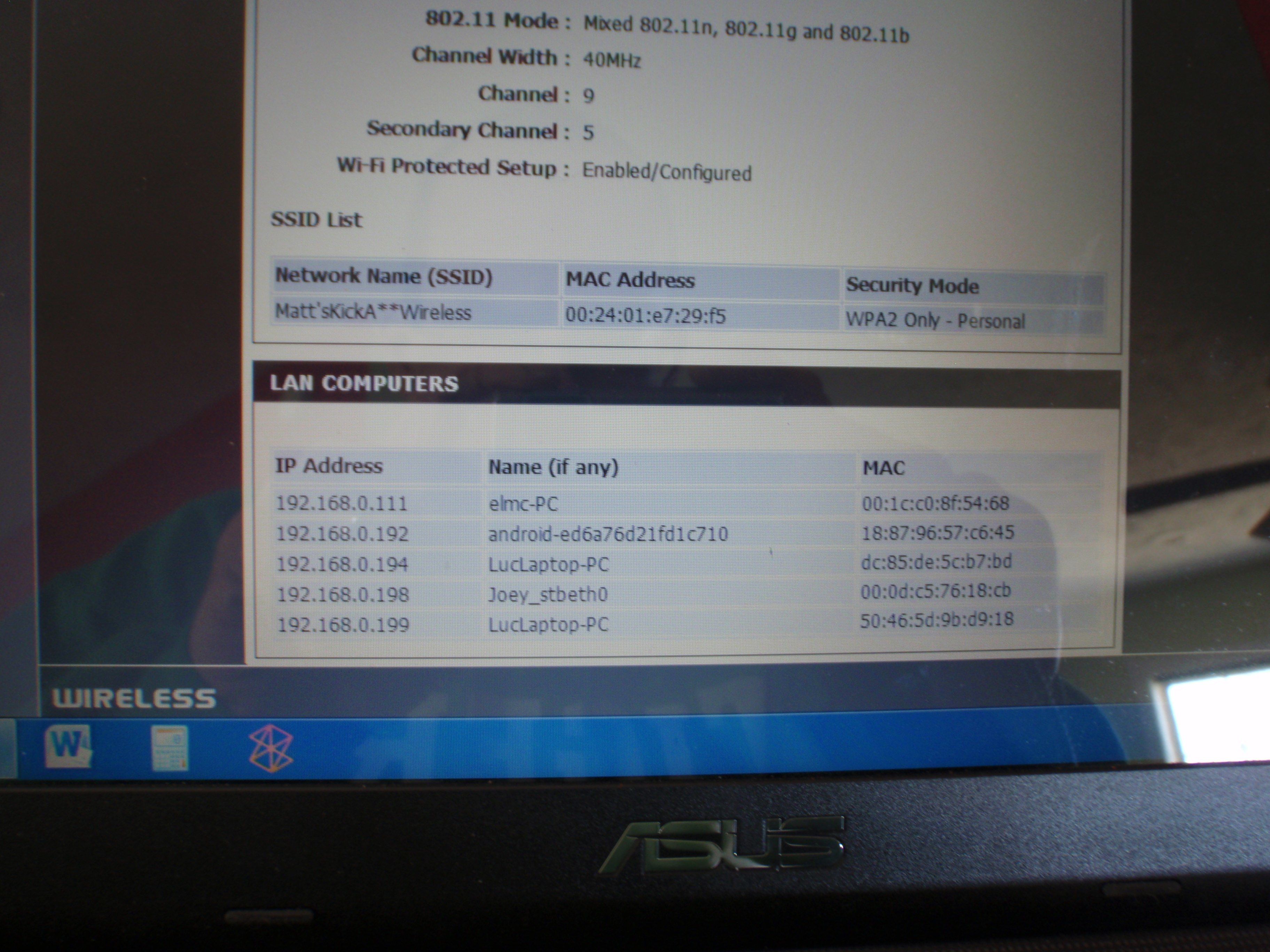

Here in pics 2 and 3 you can see my DHCP settings in my router

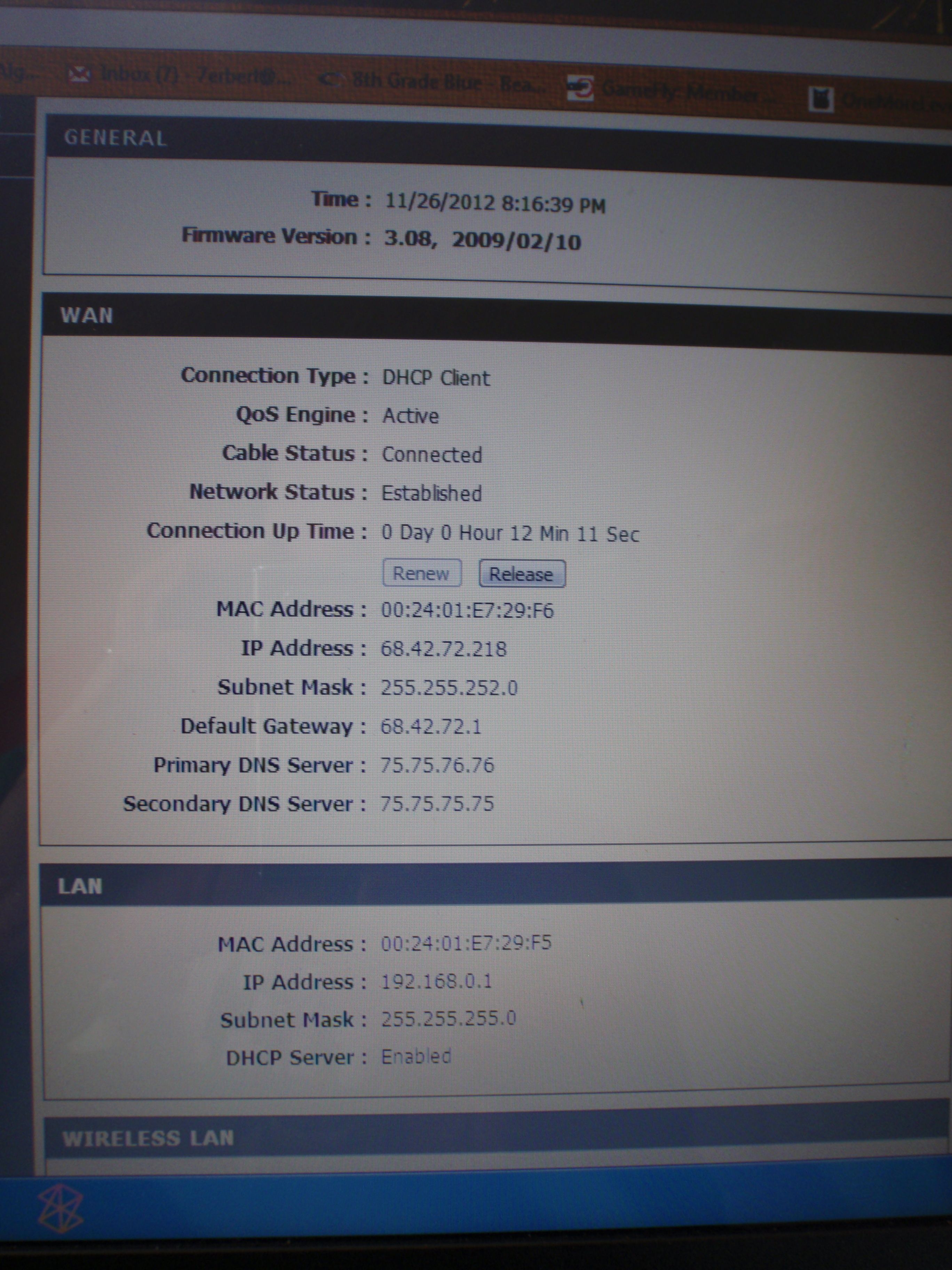

Here in pics 4 and 5 you can see my general status of my router

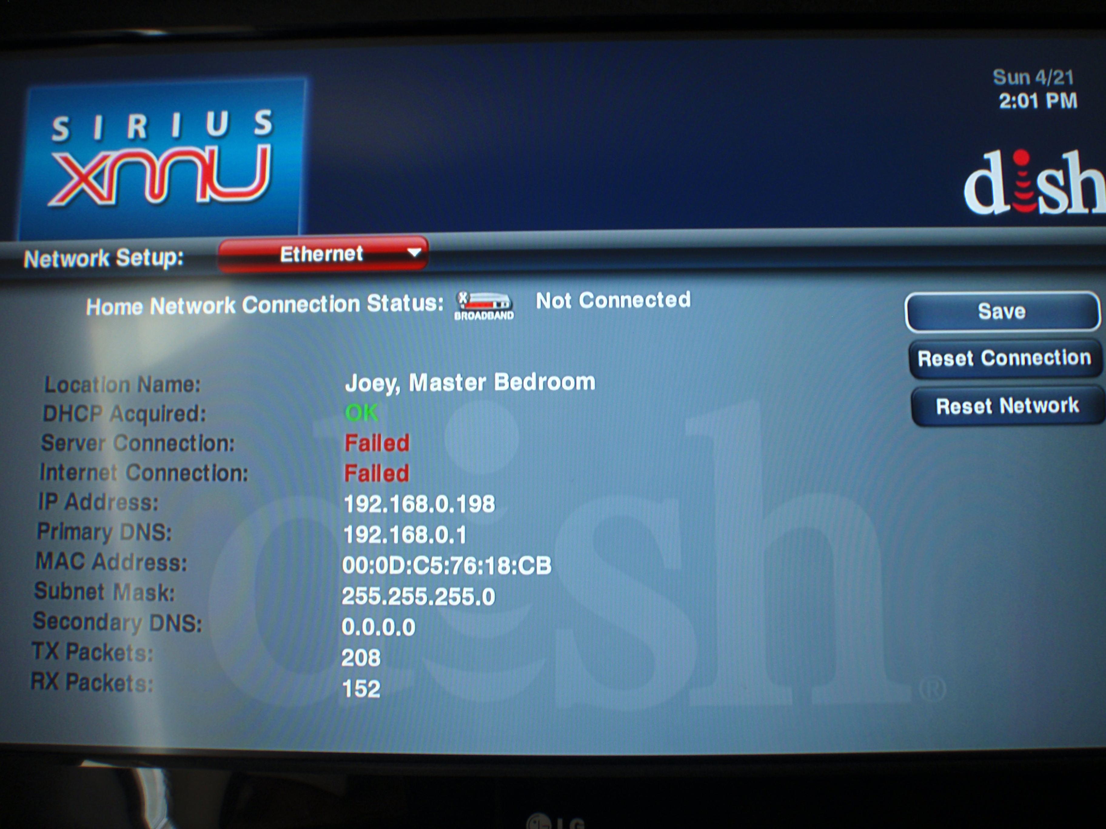

Here in pics 6 and 7 you can see the updated general status after connecting to joey and the broadband setting page from that joey.

The joey does not let me use any internet enabled functions even though it shows up on my router status.
