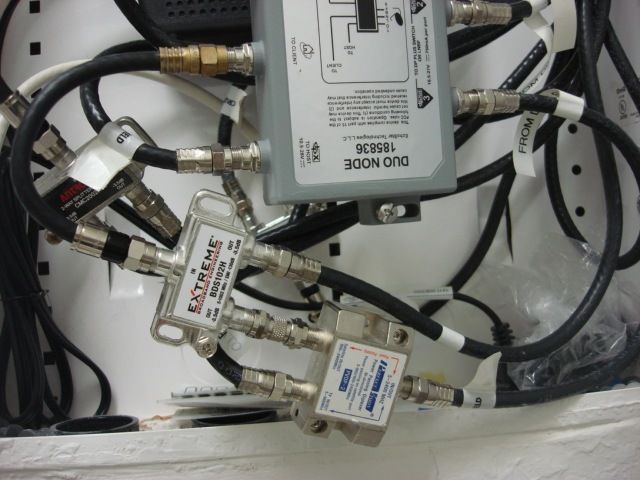

Yes I do. Now remember, that hopper already has a sat feed coming from the node on its own independent coax in that room. Since you can't use a diplexer on that hopper due to frequency difference, I used the the room next door which has a Joey and used the diplexer there to break out the Joey feed and the ota feed coming from the node. I then drilled a hole in the wall to bring in the ota coax into the hopper room and plugged it into the ota dongle to the hopper giving ota to all the joeys. The frequency out of the node for the joeys is 5-1000 MHZ so the diplexer works fine. I have attached a picture showing how it's connected.

That doesn't make sense. Having the Hopper or the Joey line diplexed shouldn't make a difference. OTA and MoCA share the same frequencies so there would be interference regardless. Not to mention that the diplexers are designed to diplex a sat feed (950-2150MHz) and a VHF/UHF feed, not two feeds with similar frequencies.
Does System Status show four green bars on all receivers with that setup? OTA reception is unaffected as well?

OTA is unaffected but now that you mention the status, I checked the system status on the 2 Joey's that I'm using and its showing 4 yellow bars on MoCA. The Hopper is showing 4 green bars. I'm still getting all my sat channels and ota on the hopper and the joeys. To me that's what matters.
