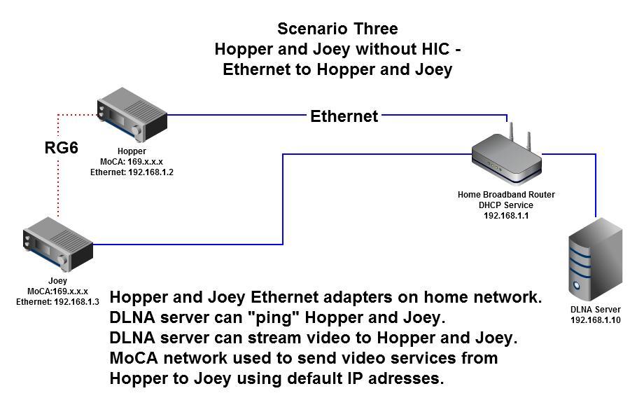

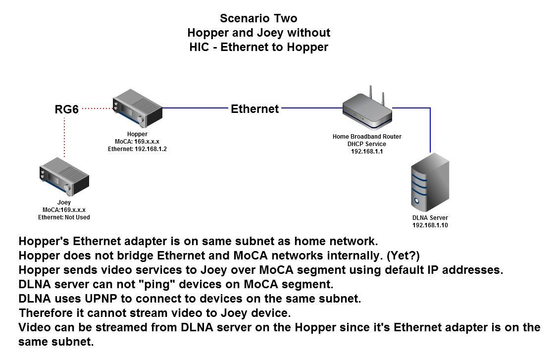

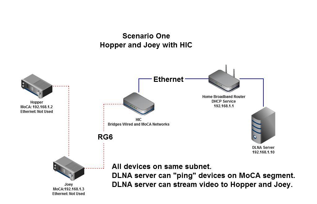

EDIT: Okay. I whipped up these three diagrams to help explain. Let me know if this helps clear things up.
I still think you're missing my point. I'm talking about item #5 on the release notes: "5.fixed - Joey showing not connected even when it is connected through the Hopper". That implies that the Hopper IS bridging the Ethernet and MoCA networks, at least as far as Internet access (for what? apps?) is concerned. So why not DLNA as well? Or if I'm mis-understanding it, then what "connection" of the Joey are they talking about?
I am going to play with DLNA on my Hopper/Joey and see what happens. My TV & Xbox both do it well, so I've never even checked it out. I will report back my findings. I do not use a HIC. My Hopper and Joey are direct connected to my network via ethernet (Scenario 3 in Dustoman's diagram).
I was going to get a HIC, but I already have 2 ethernet ports plumbed in at each TV location, so I went for the direct connection. I use TVersity as my DLNA server.
Is it better to have HIC or have your hopper hooked up with the ethernet plugged in the back of the Hopper???
Can someone explain #3 for me haha
