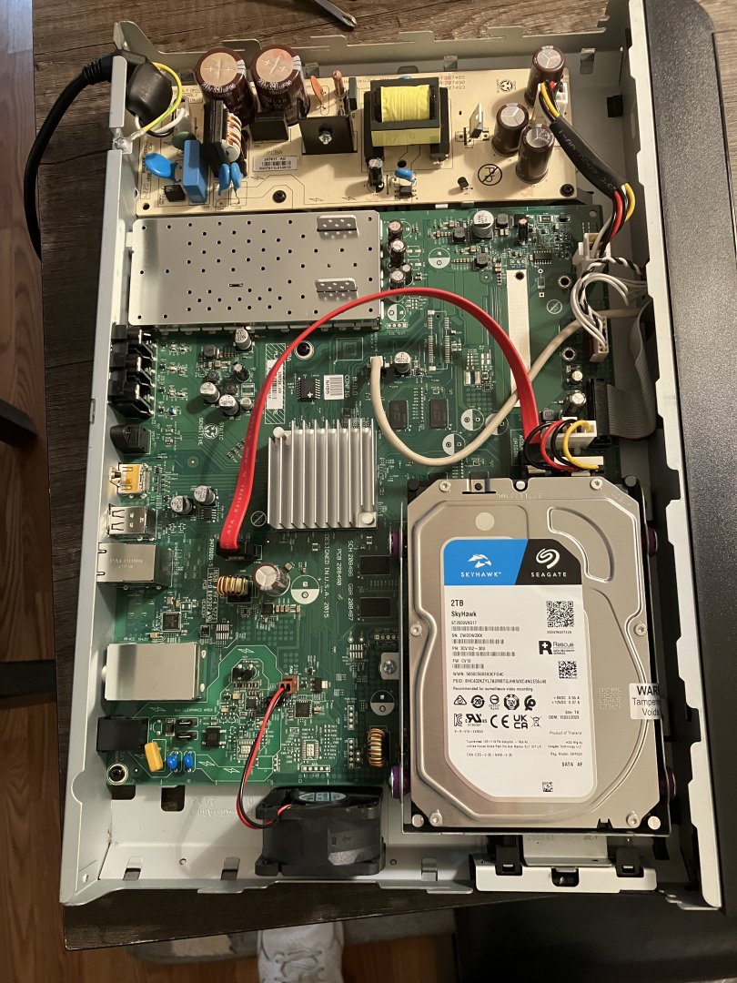

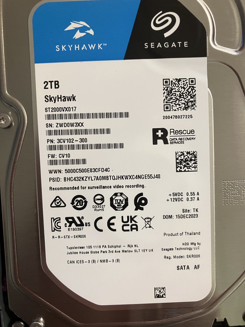

I received my replacement Hopper 3 today. To my total surprise it was brand new! I was sure there were no more new ones. It says new on the box. Here is a picture of the HDD that is in the receiver. HDD manufacture date is Dec 15, 2023. I didn't get a picture of my other Hopper 3 that failed but it had a Toshiba HDD Manufacture date of Jan 2013. Board failed on the other Hopper.. HDD is still good
