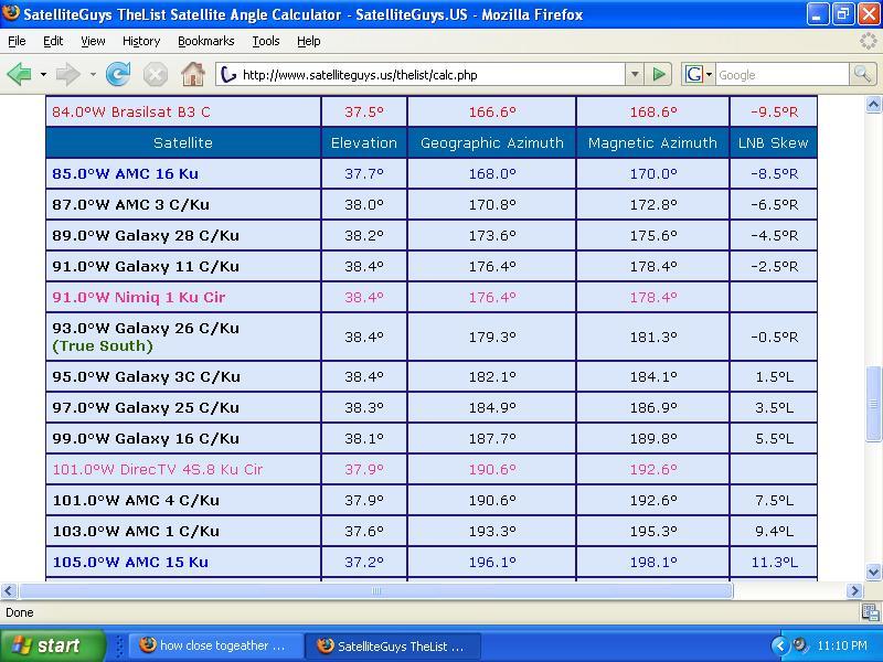

Where I am located (Minneapolis, MN) I'm at 93W.....so thats my true south (highest satellite in the sky)...for me there are a bunch of satellites that are at or real close to the same elevation...see the below pic...anyone in the midwest kinda runs this same setup...a bunch of sats near the same elevation
but for someone say on the coasts (E or W) the amount of satellites that are the same elevation is probably smaller due to the amount of sats in that area. West coast especially. The gap for sats is more than the Midwest...west coast would have 129,127,123,121,116.8,113,111.1,107.3...theres some big gaps there versus midwest where its every 2 degrees from 83 to 107.3
