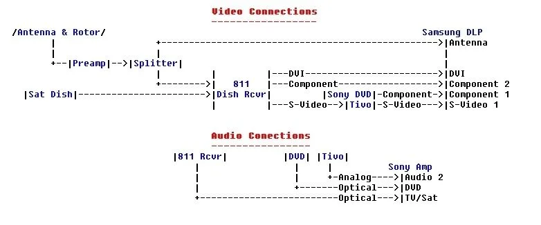

Mine works good this way:
811---component-------TV
Optical------------------Sony Amp
811---S-Video---TiVo---TV
811---RCA-------TiVo---Sony Amp

does your sony tuner have 2 tv inputs? my denon avr has one tv setting that needs to be either digital or non-digital (eg. optical or rca). it doesn't seem like i'm able to tell it to use optical when viewing tv through component and rca when viewing tv through s-video. thx for your help
