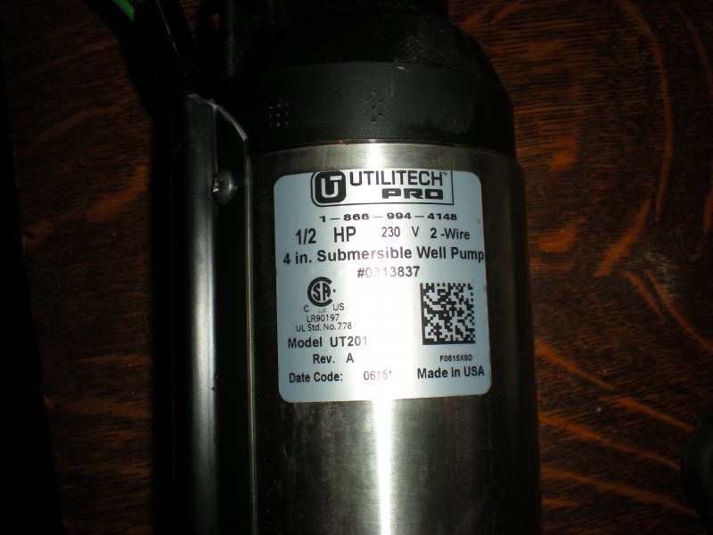

Here is the new pump I put in last Christmas. I have all the pictures from the install just need to find them. I seem to remember one run of the yellow jacketed 12/2. I am ok with some electrical stuff. As i am always rebuilding arcade games with switching power supplies and such.
Thank you for all of your time.

That confirms my suspicion; the label says 230V, which is in the 220-240V range. And being a submersible, I would be very surprised if the pressure switch is not at the house, which means there's only power on that circuit when the pump is actually running. Sorry about that, but I think your best option will be running a new power line for 120V and connecting it to its own circuit breaker in the breaker box. There may be some ways to hack around that but in the end I suspect you'd wind up spending more and having a less reliable setup than if you just ran a new wire for the computer and network equipment.
No the switch sits right under the well lid on top of the air tank. It's all combined at the well man. I'm good!

Great! Then all you need to do is make sure your computer and/or networking equipment gets the correct voltages and that you minimize the amount of "kickback" voltage from the pump that reaches your equipment. Perhaps if you talk to an electrician they could advise you on the best way to do that. I would suspect something such as this would work but I don't know; it might be too little or it might be overkill, and I am not an electrician so I'm not even completely sure it could be used for this purpose:
