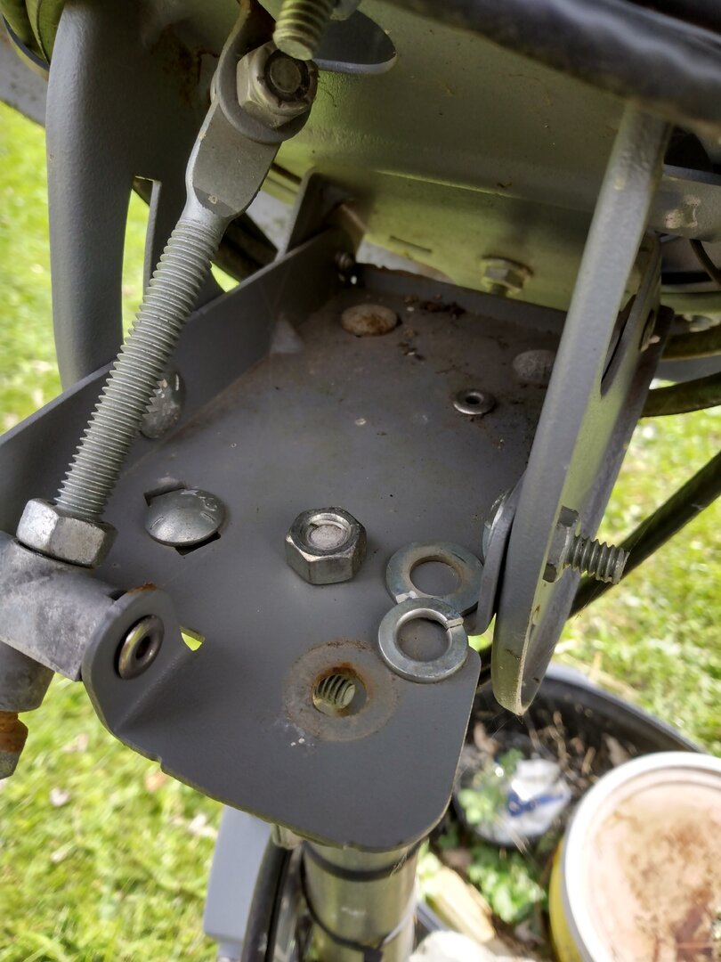

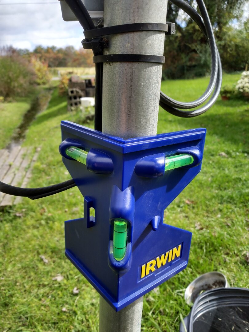

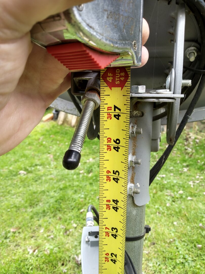

A local retailer put this dish in, I think about 10 years ago. I don't remember how long the pole was, but as you can see there's 4 feet above ground, so I'm sure there's no more than 2 feet underground, if it's even a 6-foot pole and not 5 feet. More to the point, the ground was very rocky, so he barely dug a hole wide enough for the pole and the J-mount foot he put on it to keep it from turning. I think he barely even used half a bag of cement. As a result, the pole has been leaning more and more over the years. When I start to lose signal I adjust the dish a bit. but it's now leaning in two dimensions, the hardware is getting rusty, and one bolt has even broken off somehow. I wish I had raised hell about it when it was done so I didn't have to pay to get it fixed later, but it seemed to be holding at the time. I'd like to get this fixed up properly before winter, because I don't know if it's going to survive another winter, and I really don't want to be adjusting it in the middle of winter.

You could also do it yourself. The proper way would be a 7-8' pole with 3ft in the ground. A lot of times it's hard to get past 2' though but that's my personal minimum is 2'. And then you can drill holes in and insert 3" lag screws as well as hammer down the end and it will never spin. The outside diameter we use is 1-5/8". (Might be 1-7/8" I can't remember lol). I'd have them replace the whole dish too. That's a 1000.4 dish which we basically don't use anymore and it's bigger and heaver which puts more strain on the mount. Personally if it was me I'd put the pole in myself that way it has time for concrete to cure and it's done right then I'd call dish for a tech visit and the morning of tech visit I'd take a pole or bat and beat the crap out of the dish and lnb firing them to replace it because some of the techs won't replace unless absolutely necessary lol.
