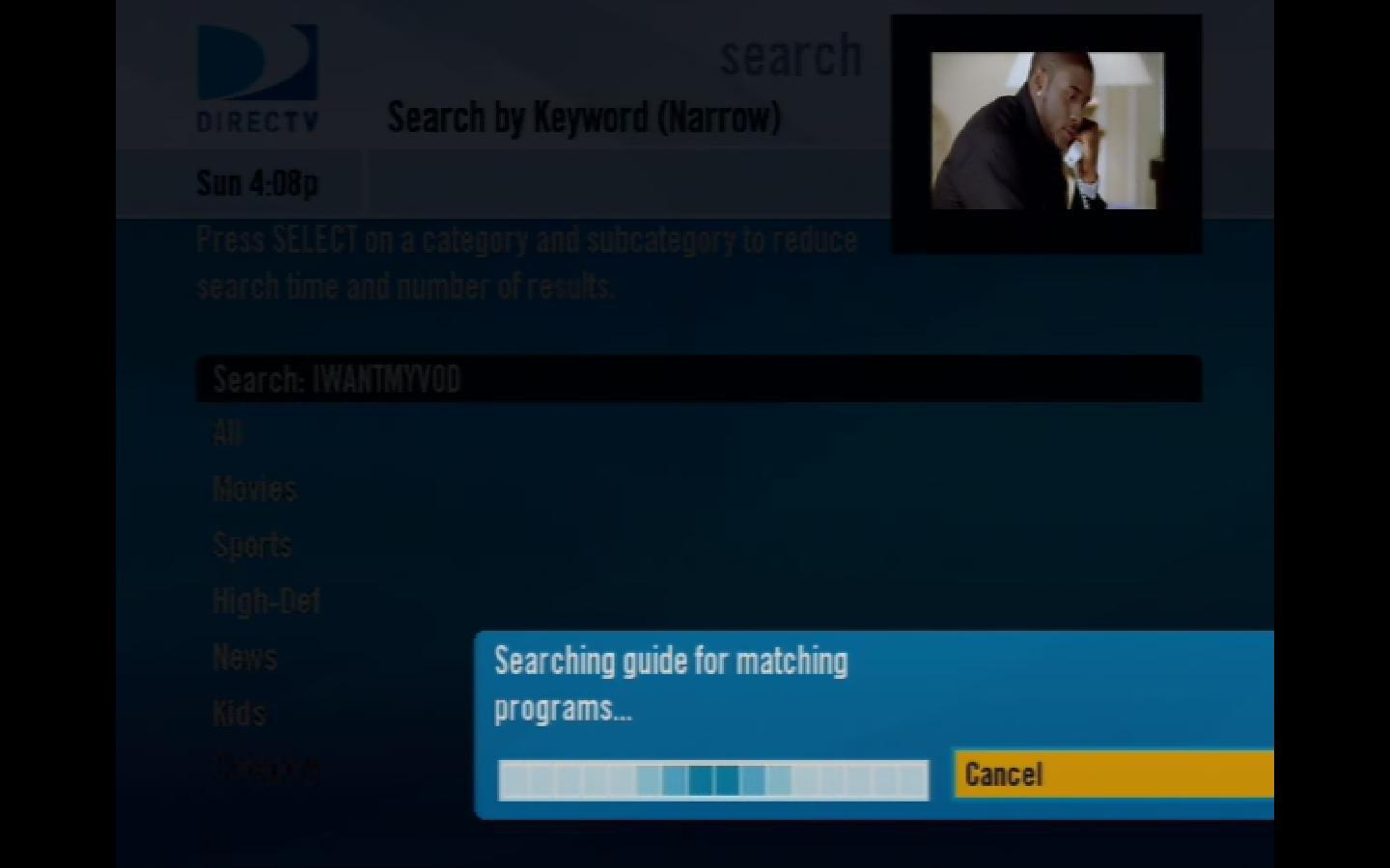

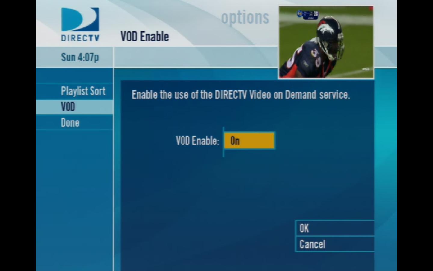

And how else would you expect it to be activated: a Keyword search and the Misc. Option menu.
Keyword Search: IWANTMYVOD
Front Panel: Menu & Info
Displays the updated screen: Misc. Option Screen
Tip: remember to select OK on the Misc. Option Screen.
Tip #2: remember to check your channel filters
Tip #3: If after an hour or so, nothing enables... try a reboot.
After enabling the option, some features may not fully enable immediately.
Remote Booking will not be automatically enabled by this procedure, that feature/option will be enabled over the next few weeks.
