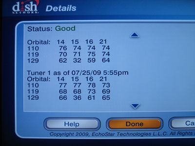

Heavy rain cloud cover is every afternoon here. I'm in North/Central Florida (Gainesville). I do have an antenna that I intended to use as backup but that is pretty spotty too during a rainstorm. Below is my signal details (I think) in clear weather. Should it be better?

Those are very good signals. You need a simple ota antenna hooked up to provide you with a ota channels back up for when there is rain fade. Also it might benefit you to watch your tv shows RECORDED if you receiver is an hd dvr. I have the 722k with the dual ota tuner and I live in southeast Texas where we have rain anytime . During hurricane Humberto in 2006 , we had the 722 dvr with single ota tuner. We were able to watch our local weather on the ota channels at 2:30am in the morning when the hurricane( cat 1 )was hitting our very area. That was until the lights went out around 3:00am. If you are not very far from your broadcast towers like I am ( 25 miles or less), you could use the terk 44 clip on antenna on your dish to receive both ota and sat on up to 3 receivers. It does both vhf/uhf , analog and digital. I use it to with a mult splitter and get ota reception to my 722k, my tv, my computer room tv, and as my fm antenna for my a/v receiver.

Signal.
Heck for some reason on that screen mine for 129 is showing 3 zero's then the fourth is a 74 is something wrong with this picture,shouldn't those first 3 have some kinda numbers.:confused:
Assuming you are pointed at 129 (lots of PA subs have 61.5 instead), keep in mind TPs 1-16 on 129 are spotbeams. So having those first 3 zero would not be odd (especially given I don't think any PA spotbeams are on). TP 21, on the other hand is CONUS, so that should have signal.
Signal.
Yeah i'm in western p.a not far from ohio,but good to know i was starting to think something was wrong does seem that 129 is the first to go when it rains though.
Likely also due to the fact it's lowest in the sky, and thus has the most atmosphere to go through, and thus the most water vapor when it rains.
