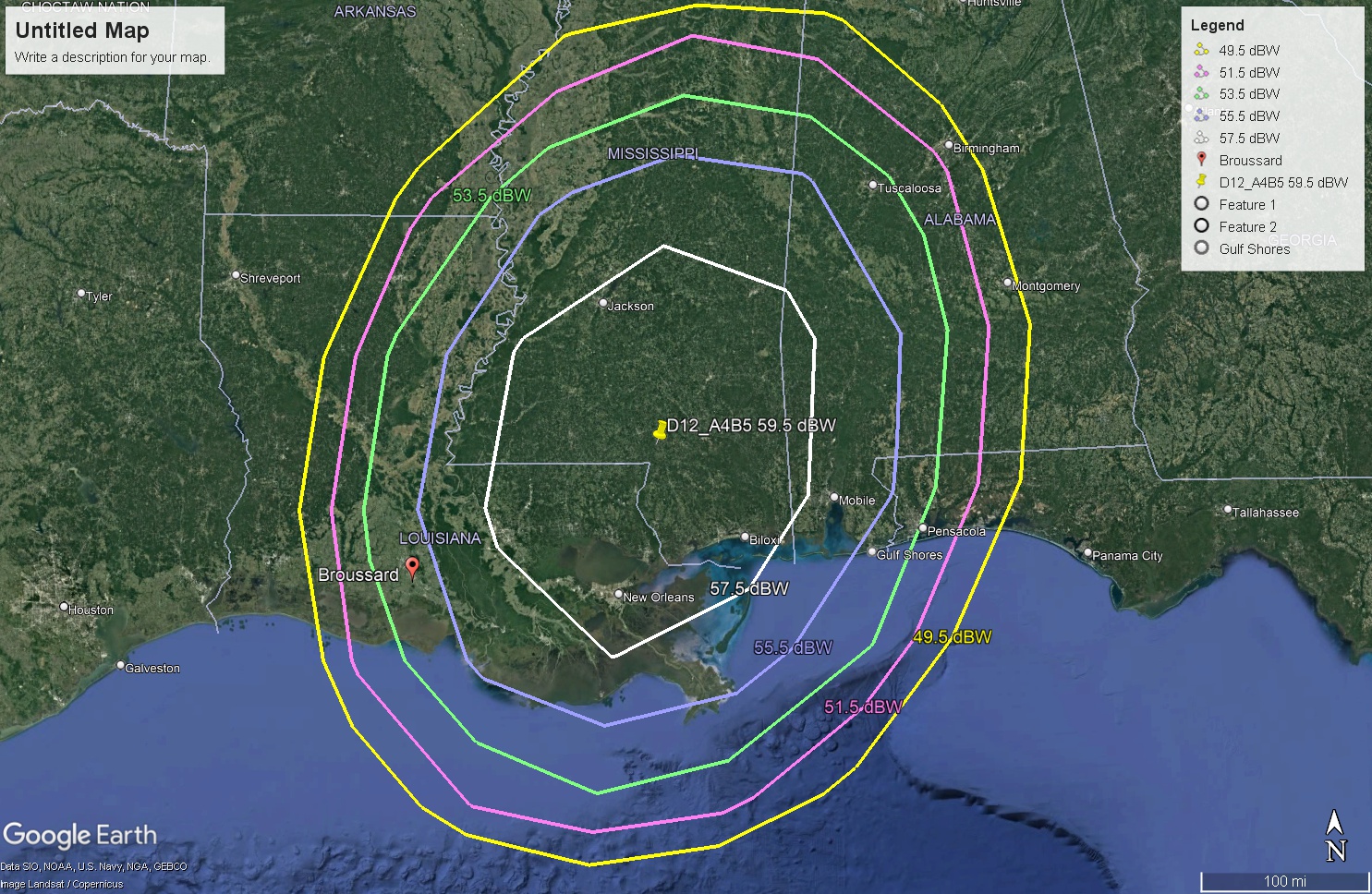

The OP's location is Broussard, LA, which is in the Lafayette DMA. Looking at the TPN Map, their local stations actually come from 99S. He is probably just checking to see if he can still get anything from 103S, since the neighboring Lake Charles, Alexandria & Baton Rouge DMAs are also fed by 99S.
Edit: The New Orleans DMA is a 103S DMA. Looking at the spotbeam map on Google Earth, Broussard is between the green (53.5 DBw) and purple (55.5 DBw) area on the beam. I remember Tom telling me 51 DBw is good enough for Ka reception, so it is definitely possible to get a good signal on 103S, or more specifically 103 S TPNs 21/TID 236 & 22/TID 237, in that area.

Using the With Spots option, what TPN would I be looking for. I see that using with spots I get 103b TPN 21 which doesn't show up on a regular test.
But the signal level that i see on the meter is quite a bit different than what the system is showing. I am working on a Technicolor COM2000 system.
As I said in the last post, your locals (Lafayette, LA) are from 99S, so if the hotel TV system you're working on is in the New Orleans DMA, you would be looking for both 103S TPN 21 & 22. The other DMAs that border the Lafayette DMA have their locals also coming from 99S, also like I said in the last post.
