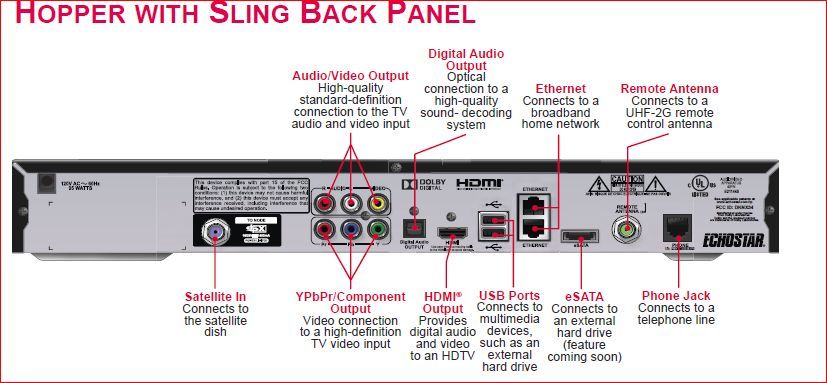

Just had Dish installed...Have 2 Hoppers and 3 Joeys. I can not get Win 7 Pro to recognize the dish signal to setup Media Center.

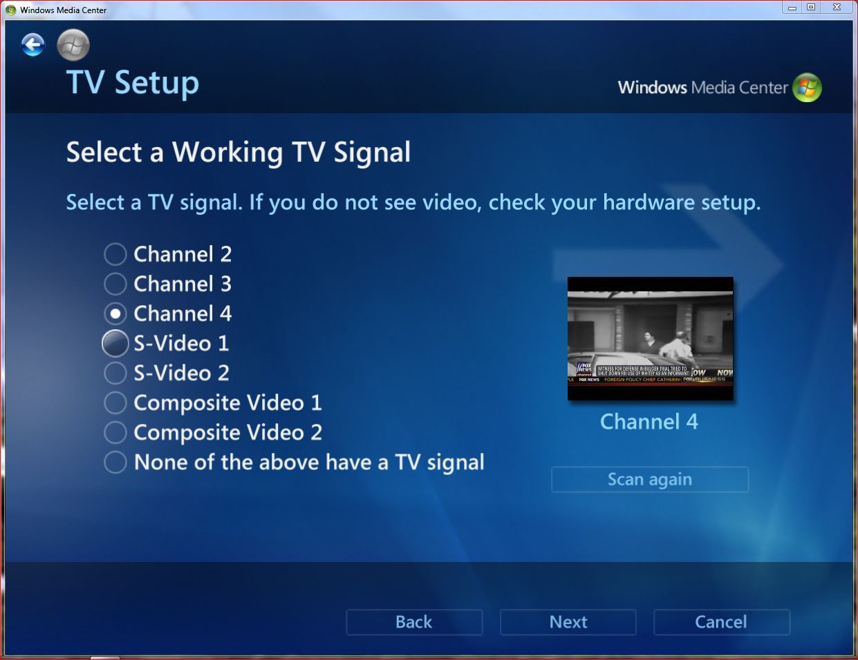

Dish apparently outputs on Channel 73...Windows Media Center apparently only gets input from 2-3-4 ? I have the following outputs on the Joey by the TV: Extra HDMI, USB, R-Y-W output jacks (2nd HDMI currently running from Joey to HDMI TV near PC)
Have a WinTV-HVR-1250 Tuner card with Coaxial, & S-video input jack
Media Center worked fine on both WMC PC's previously with Cox cable into tuner card.
How can I get an available outlet from the Joey (HDMI, USB, R-Y-W output jacks), or Hopper With Sling...to the Media Center PC in the channel options MC requires (2-3-4 etc) ?

A modulator should do the trick. It will be SD, not HD. A modulator allows the signal from the RCA outs on the Hopper or the Joey's to be converted to RF (Standard RG6) on either channel 3 or 4.
