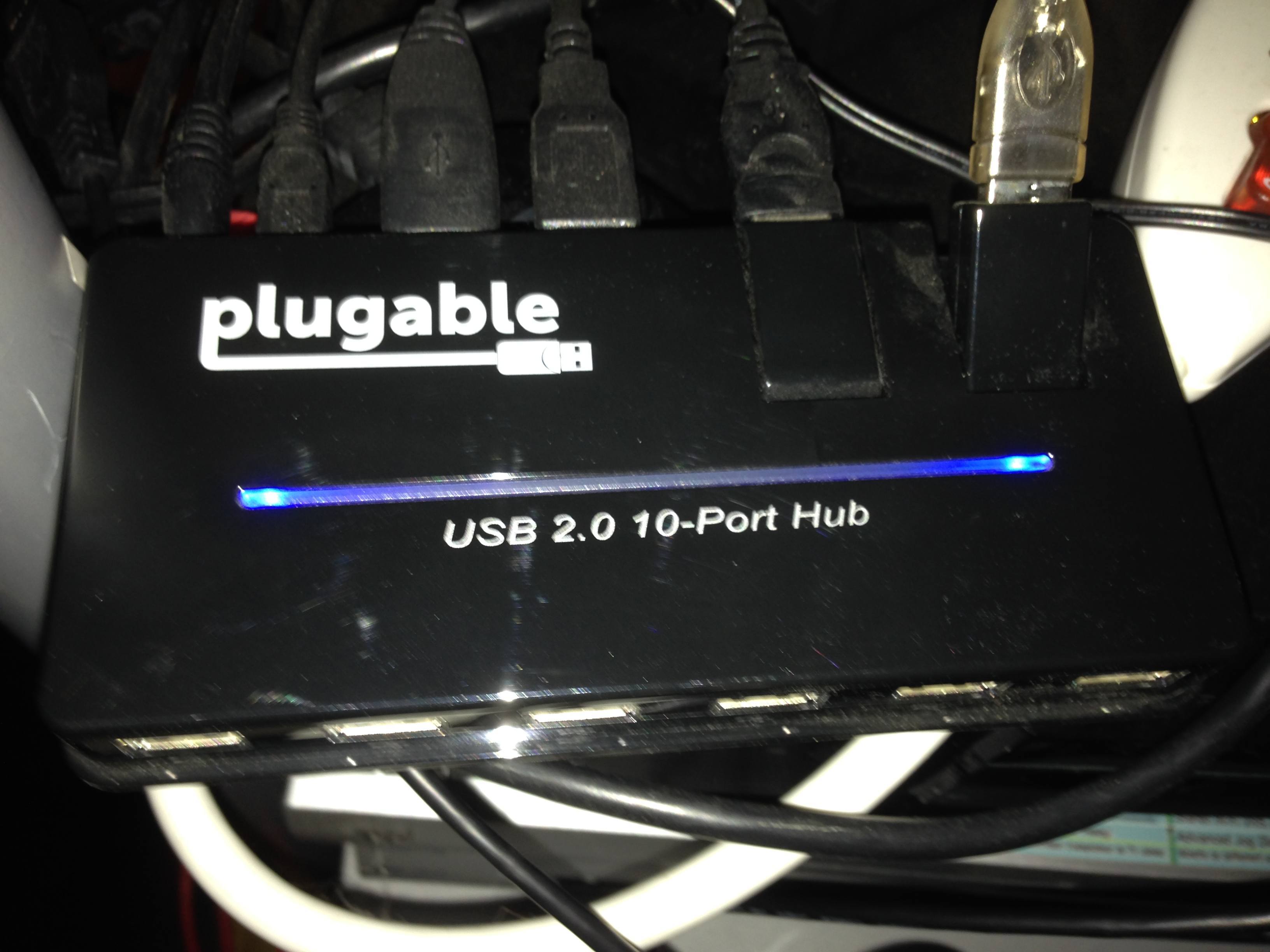

I took an SATA self powered dock and a brand new 1TB and connected it to the LR HWS via the powered USB hub (plugable USB2-HUB10S). I then transferred 6 movies to the EHD. Failed. 3 transferred. So I selected those 3 on the EHD to transfer back to the HWS. Worked. Both operations took about a half hour. I then disconnected the dock from the hub and plugged it into the front HWS USB port and selected the same 6 movies to transfer to the EHD. When the estimated time remaining settled, it was guessing about 30 minutes. That operation is almost over.

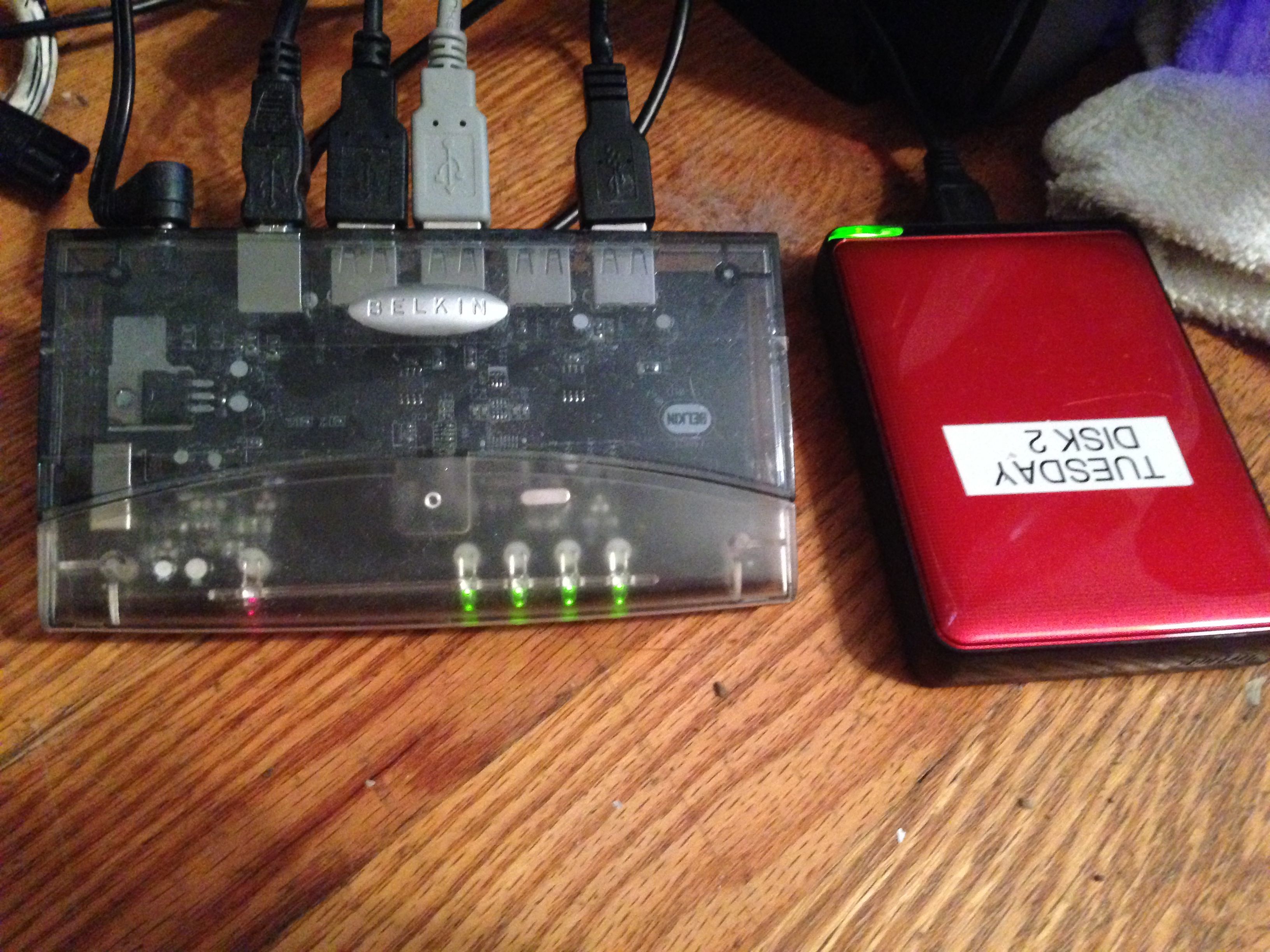

Meanwhile, I transferred 6 movies from the MBR HWS to the Buffalo via the powered 4 port Belkin USB hub. They transferred just fine. Odd that an old Belkin F5U021 might be outperforming a newer plugable model.
So either the LR USB hub is bad, or the LR HWS is bad, or there is some configuration/hardware difference between the two HWS that a software fix MIGHT correct. If the current LR transfer goes well, then I'd have to say the LR hub is "underperforming." If not, it's the LR HWS.

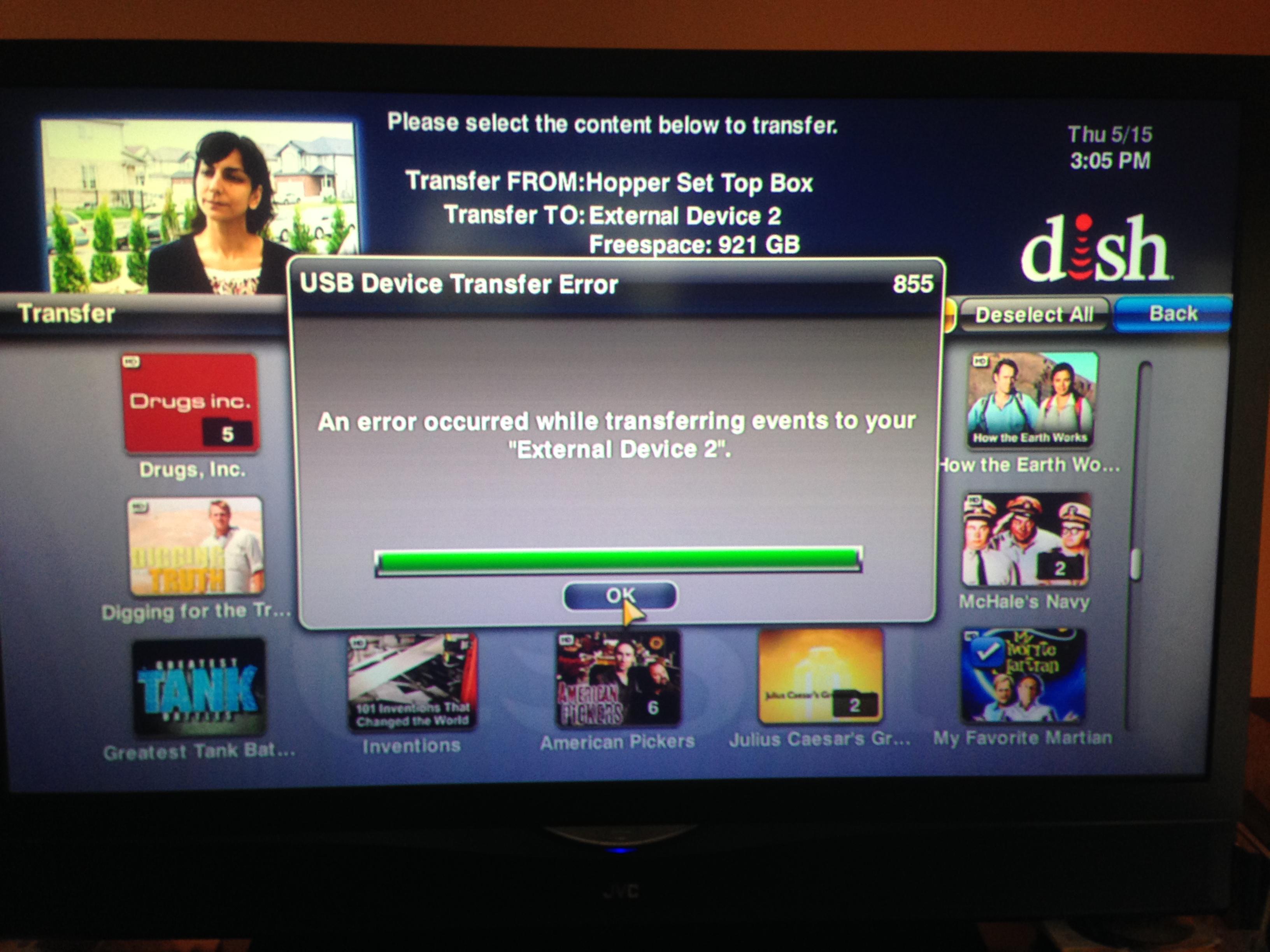

Transfer failed. 855 error screen. It's not the hub. 3 of the 6 transferred.

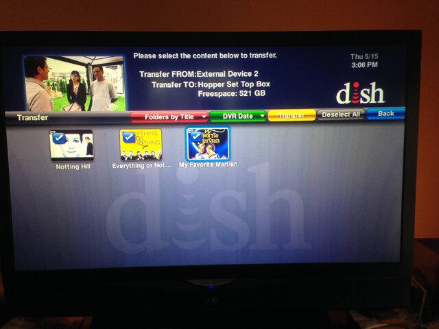

Now to check to see if any of the other 3 movies are corrupted.

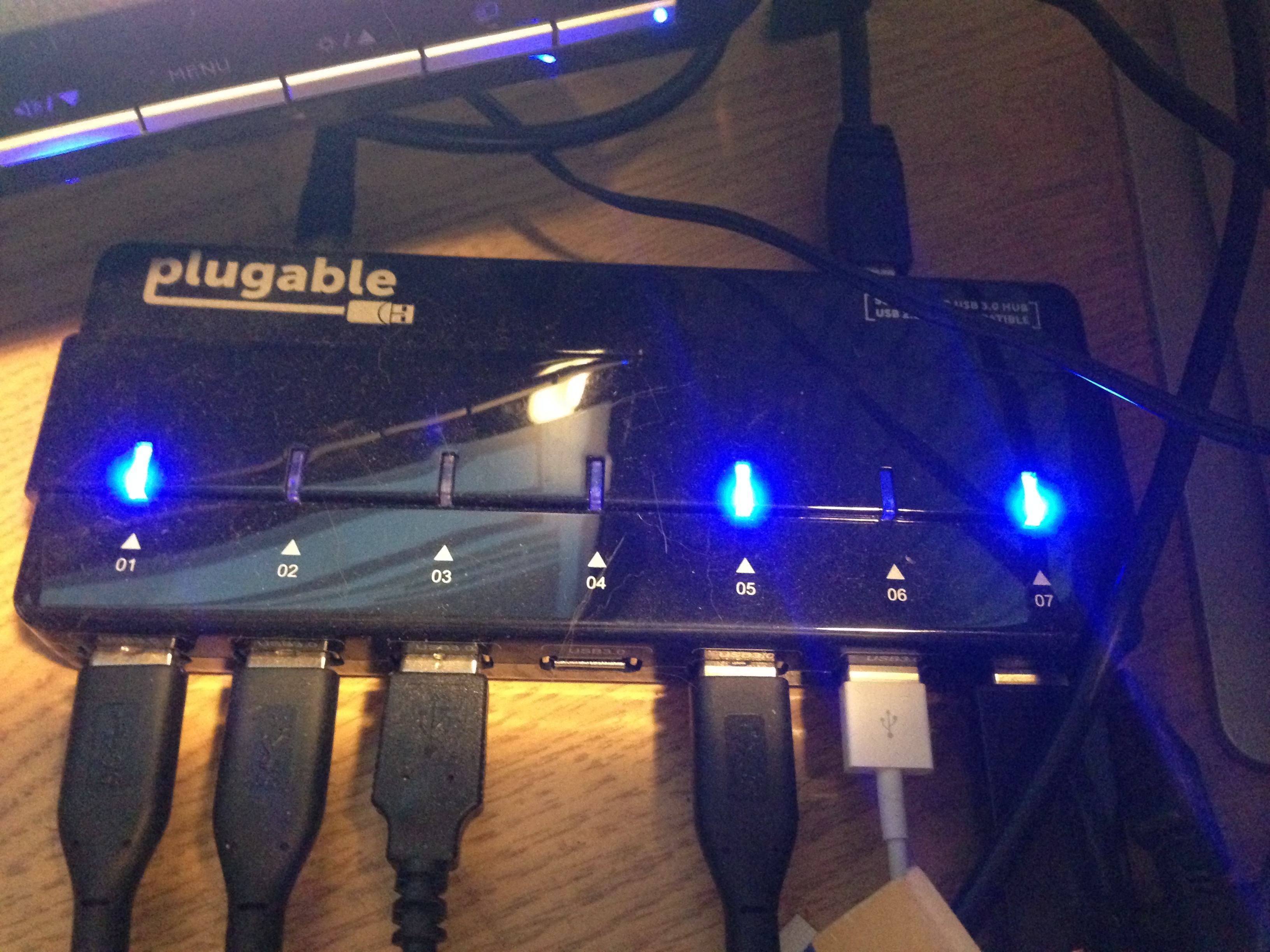

FWIW, I also have a plugable 7 port USB 3 hub, USB3-HUB7-81X, that I use on my PC. I am quite happy with it.

Three of the movies were corrupted, hence the failure to transfer.
