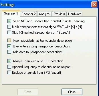

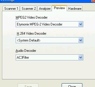

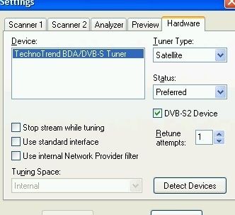

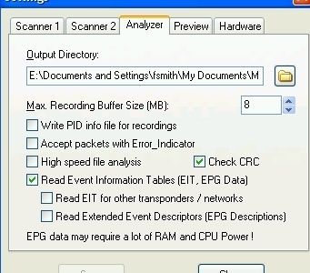

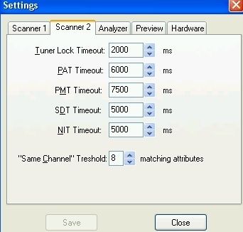

I am working my way across the arc starting from the West, and have run into a problem with Transedit scanning in a nice S2 signal.
Transedit will lock the signal and analyze it fine, but will not scan in the channels on the S2 transponder.
Transedit scans in all the other channels and sends them to DVBViewer where they all preview and play fine.
The TTViewer that came with the card scans it in fine and plays it without any problems at all. The BLSA says it is the strongest signal on that satellite.
Why in the heck won't Transedit scan in the channels?
I have tried several settings to "help" it, but none seem to avail.
Here are my current Transedit settings.
Finally!!! :eek:
I got it to work after reading on the DVBViewer forum.
I deleted the Transedit.ini file and started over.
Went through all my transponder files and set them correctly from E to W, and saved everything.
When I started it back up, the channels came in with no problems.
Don't know what the difference was, but now it works.
