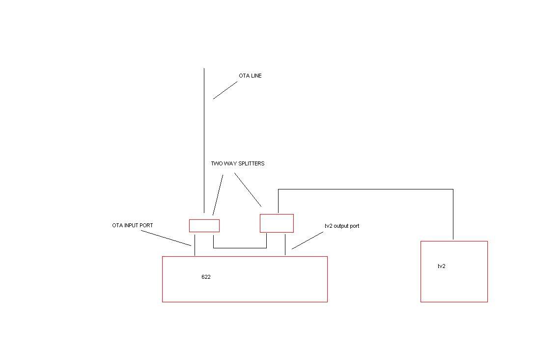

You'll need (2) two way splitters and a short coax jumper.
You'll need to set your tv2 modulated output to a different channel that is not in use on your antenna, put a good separation between the channels.
Here's a half baked diagram

Yes, you can combine any OTA or cable incoming signal into the TV2 backfeed using the diagram provided by rcdallas. You just have to use the trial and error method to find output channels for the dish receiver that don't conflict with the existing channels from the other source.
You can buy filters if you can't find an empty channel. Analog cable might stop at 60 or 70 but the digital channels fill most of the rest.
so the splitters would be behind my 622 instead of in the basement, where it all comes into the house? I just assume to do it there, but as I have said, I don't know much. I still don't quite understand how to get the sat and OTA into that one coaxial goin to that room.

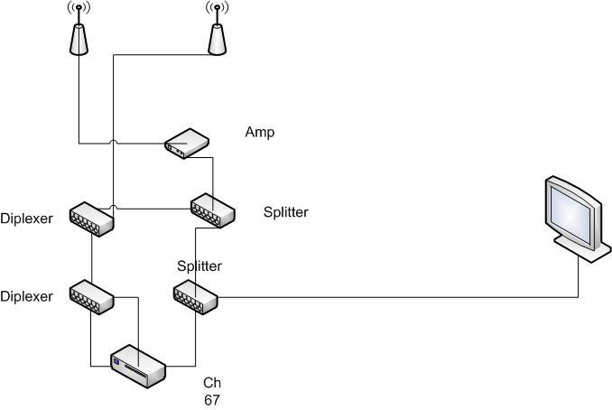

Here is how I do it. All connections done in basement.

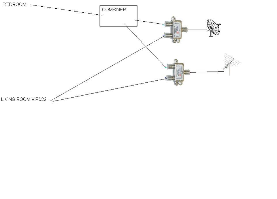

Ok, got this figured out to the best i can understand and here it is.....
sat comes into house, splits to living room, splits to bedroom.
antenna comes into house, splits to living room, splits to bedroom.
My living room has two coaxial so it is OK for sat/ota to run seperate to there.
My bedroom has ONLY one coaxial, so to run both the sat/ota I need to combine these signals using a combiner and my tv will realize channel 73 is sat and the rest our my locals in HD.
I ran this by a guy I work with and he says it should work, but would like your final approval. I've attached a diagram.
Thanks as always, I have solutions. More importantly, I've learned a little.

You can't split a satellite signal like that.
