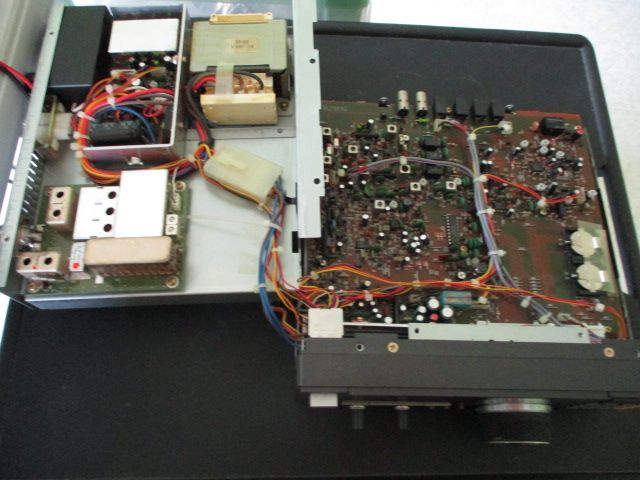

Mike, wish I had read your post sooner. Spent a few hours yesterday morning just changing the two 2032 memory batteries. One is for the clock, other for the 900 memories. The manual was not complete in their description of how to replace 'em; it was much more complicated. I'd say this was the hardest battery change to deal with so far, but at least Icom didn't solder them in place. It was a good learning experience though.
When buying older equipment always keep in mind that memory batteries get old and may need replacement. Some radios like the Yaesu FRG-100 make it a snap while other radios like some 2 meter xcvrs require soldering and lots of complicated surgery to get to. When I start alignment will take photos Mike. Thanks.
I agree on some make it very complicated. Almost as if they figure the radio with be trashed by the time the battery goes dead. I have a replaced the battery in quite a few 2 meter/440 mobiles, that did take some extensive surgery!

A follow-up photo of the R-7100A once the upper and lower chassis are separated. The two coin cell memory batteries are on lower right.
