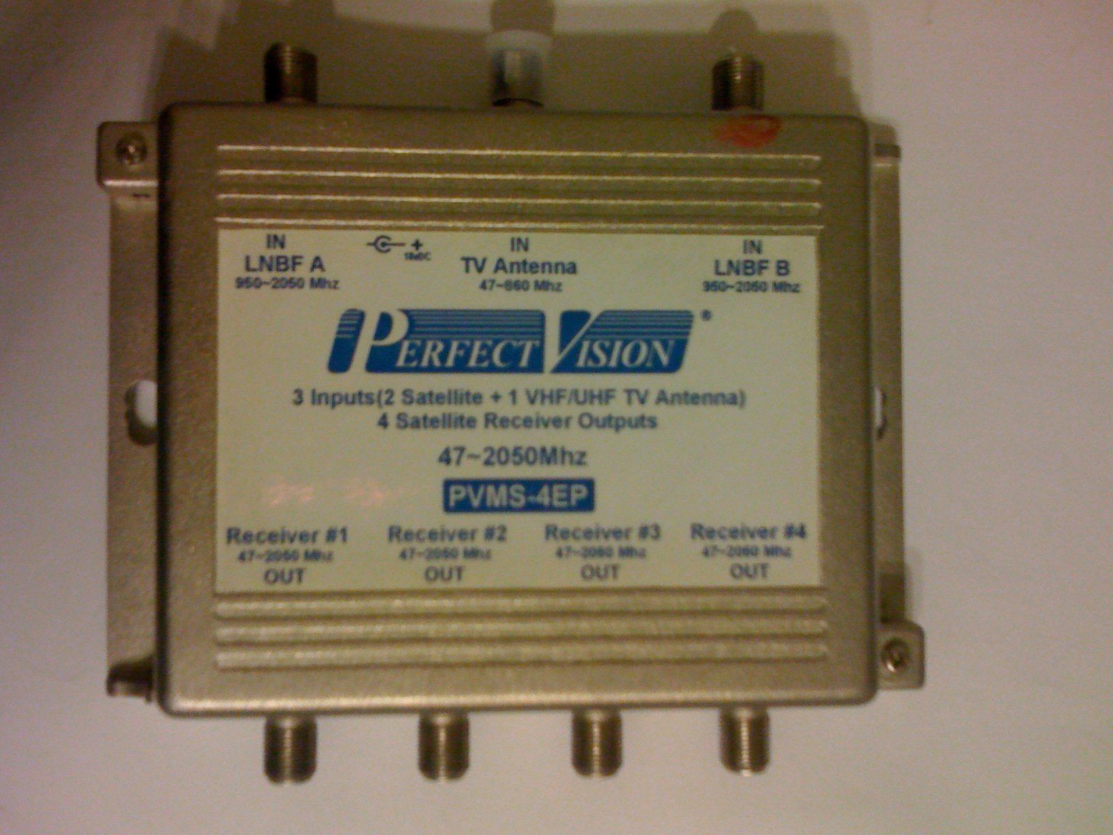

Hey guys, what is this thing for? It says you can put four tuners on it, right?
But only two dishes? Or is this just another white elephant I found lurking the the dark recesses of the tool shed?
Thank you! :)

Thats a 3x4 multiswitch. You can combine 2 sep lnbf (or 2 sep dishes) into that, and output to 4 diff sat receivers, so all 4 could have channels on both lnbfs or both dishes. You can even mix in your outdoor over-the-air tv antenna signal to it, if you want, and using a splitter indoors, separate that signal out to your tv for the local channels. They are also handy for those older primestar lnbfs that have a sep H and V output port--lets you combine both into one cable coming indoors.

Hmmm... Ok.. So I guess I should hang on to it for some future use then.

So he reveals this info to me when I was asking him if he could help me put more than four satellites on at once. We had a pretty long chat about satellite stuff. Mostly me asking stupid questions.
So long story short, he said yes, he could help me add more satellites. So he helped me find the right thing online, it's an 8 connector type. So I can put 8 satellites on it. :shocked OMG... I must be nuts.
Well, the little thing is pretty cheap so I went ahead and ordered one.
