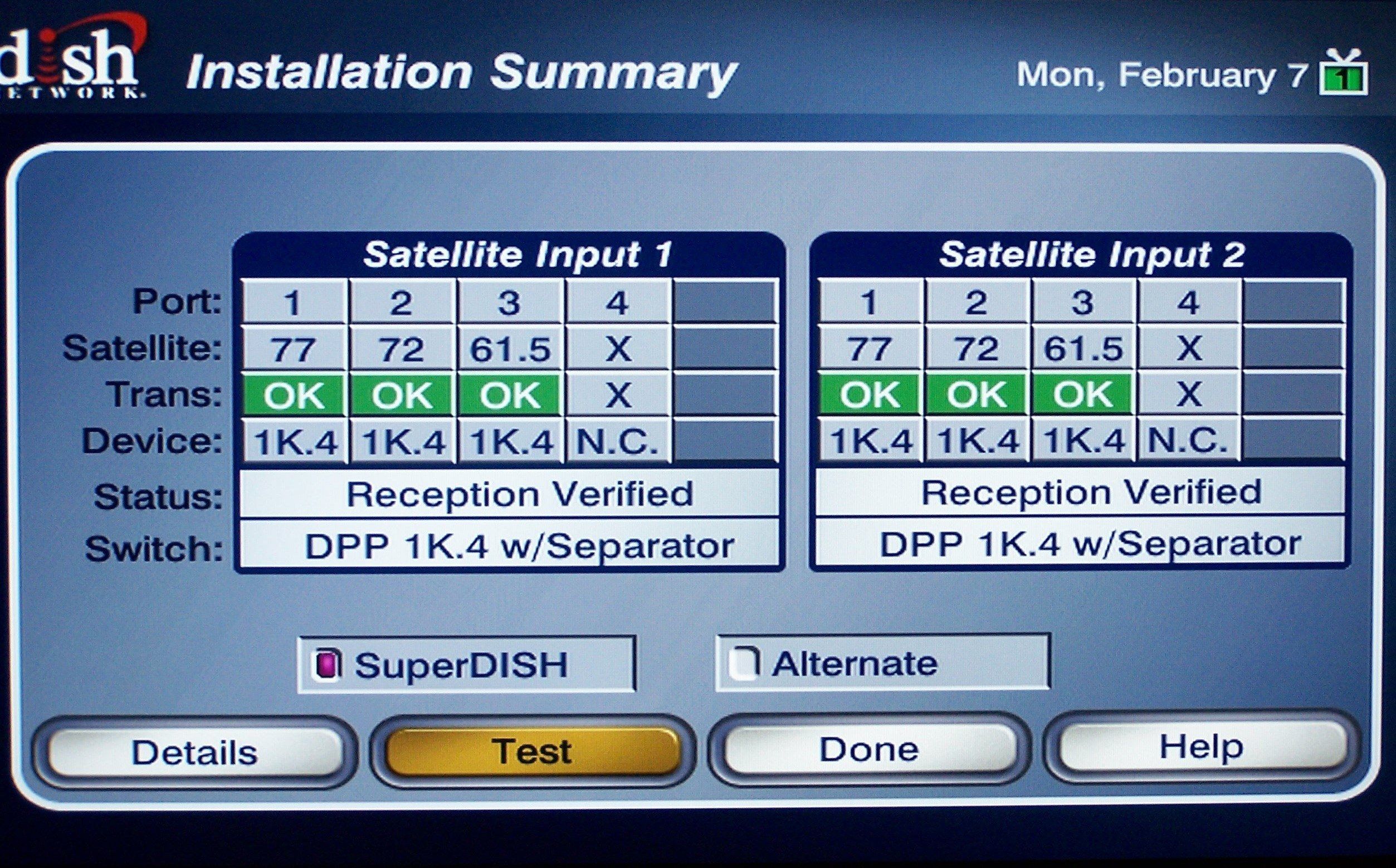

Had to install my replacement 722 yesterday. The included instructions do not reflect the new EARC dish. It wanted me to aim at 119 for a Dish 500 and do a Check Switch. Could not get past that. Had to cal tech support and was told that all I needed to do was point to 72 and wait till the signal was acquired and select Done. Also. there should be instructions not to connect the EHD till everything is back up and running.

No. I should have made myself clearer. This was at the Point Dish Screen. Had to change from 119 to 72. No actual physical change. After changing the Point Dish to 72 I just had to select Done.
I understand dwarren2's frustration/confusion. This stuff needs to be updated and simplified. Three things DishNetwork could do is..... 1, reduce the number of receivers. How about just two receivers. 1 dvr and 1 non dvr receiver. (well maybe three, a whole house fully capable receiver but that is another can of worms) What ever options either one could provide pending activation. 2, simplify the channel groupings I can have. 3, the user installation guides on the receivers need to be updated and be made more user friendly. I currently have two stable 722k's with a 1k.4 dish antenna. Look at the picture below. I haven't used a superdish in over 5 years......

When your idyllic suggestion comes to fruition, let me know. Until then, it's a business. You can just de-select the superdish option and run the test again, won't make a difference either way. The only ones it really matters for have DP Adapters.

Wait for it.:rolleyes:...... Still a business?.. Whats that supposed to mean? Never mind. :facepalm The picture I posted and referenced just show why things need updating..... My comments were not meant as an insult toward Dish.
