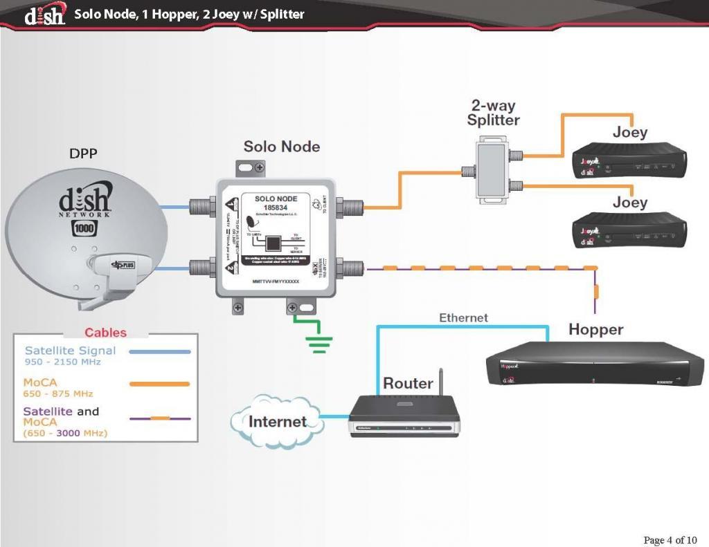

You have to have a DPP lnb to the node.
Look up a wiring diagram for the hopper system. You need two cables going from the LNB to the node (wherever you put the node), the a single cable going from the node to the hopper and a cable from node to joey. It can be done, but it may be more involved that just dropping it in with existing wiring.

Like this right
One coming out of node and ran to satellite connector on camper and the other one for the joey ran from node to connector they labeled internet?

The above solution will work. You will need to upgrade the "Cable" coax input with 3GHz barrel connector and 3GHz cable.

My setup is very similar to what you want to do, just making it all come together is the difficult task. Two cables from dish to solo. Then your existing cables to the solo. As others have pointed out, your wiring might not be up to the task. Be aware that if you are currently hooked up with a duo node at your house that every time you move the Hopper and Joey that you will need to run a check dish as part of your setup.
