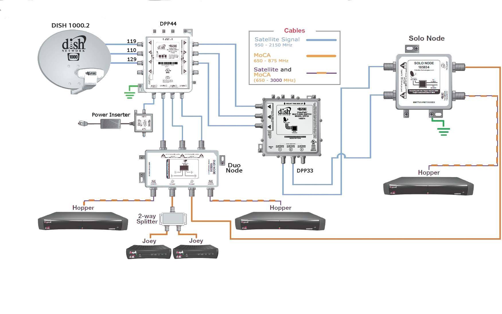

Thank you, that's one of the best I found too. I was looking more for a diagram of the wiring nodes used and placement, etc. I'm more visual, pictures.

Per PM Request :-
My 3 Hopper setup with 2 Joeys. Note that Ethernet/Wireless connections are not shown. Also note, that I use nothing but RG6. RG59 may work for the MoCA (CLIENT ports,) however I do wonder if it could cause issues with large numbers of devices.
Hope this helps :) .

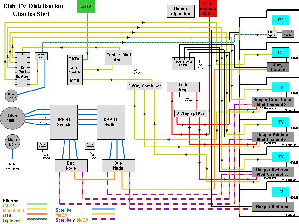

Here is my setup. I have my wing dish disconnected.
