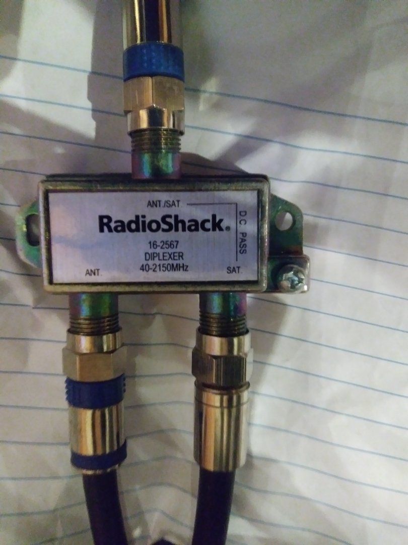

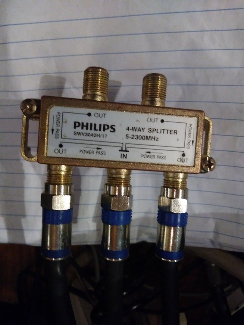

Hello this is how i have my setup i have a 2 Orby receivers,it works okay for me, hope this helps. planning of adding more receivers one day.
The Diplexer ant/sat output goes to the 4way splitter input.
