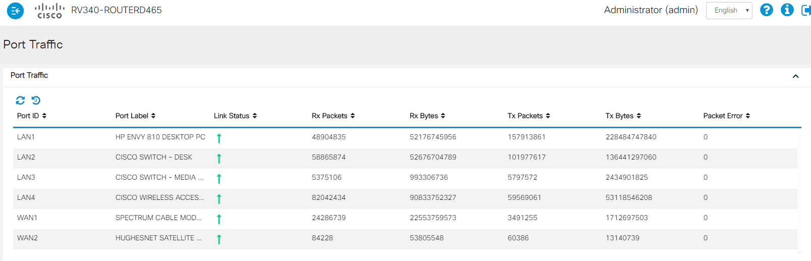

If you've determined that you have a lot of phantom bandwidth on your network, the next step I would take is to figure out what devices are responsible for that. In the GUI, I can see the # of packets and bytes in both directions going over each port on my router. The numbers get reset when the router gets power cycled. If you have something similar in the GUI you could reboot the router and then watch the traffic stats in real time as things start to come back online and see what is using a significantly more amount of bandwidth.
