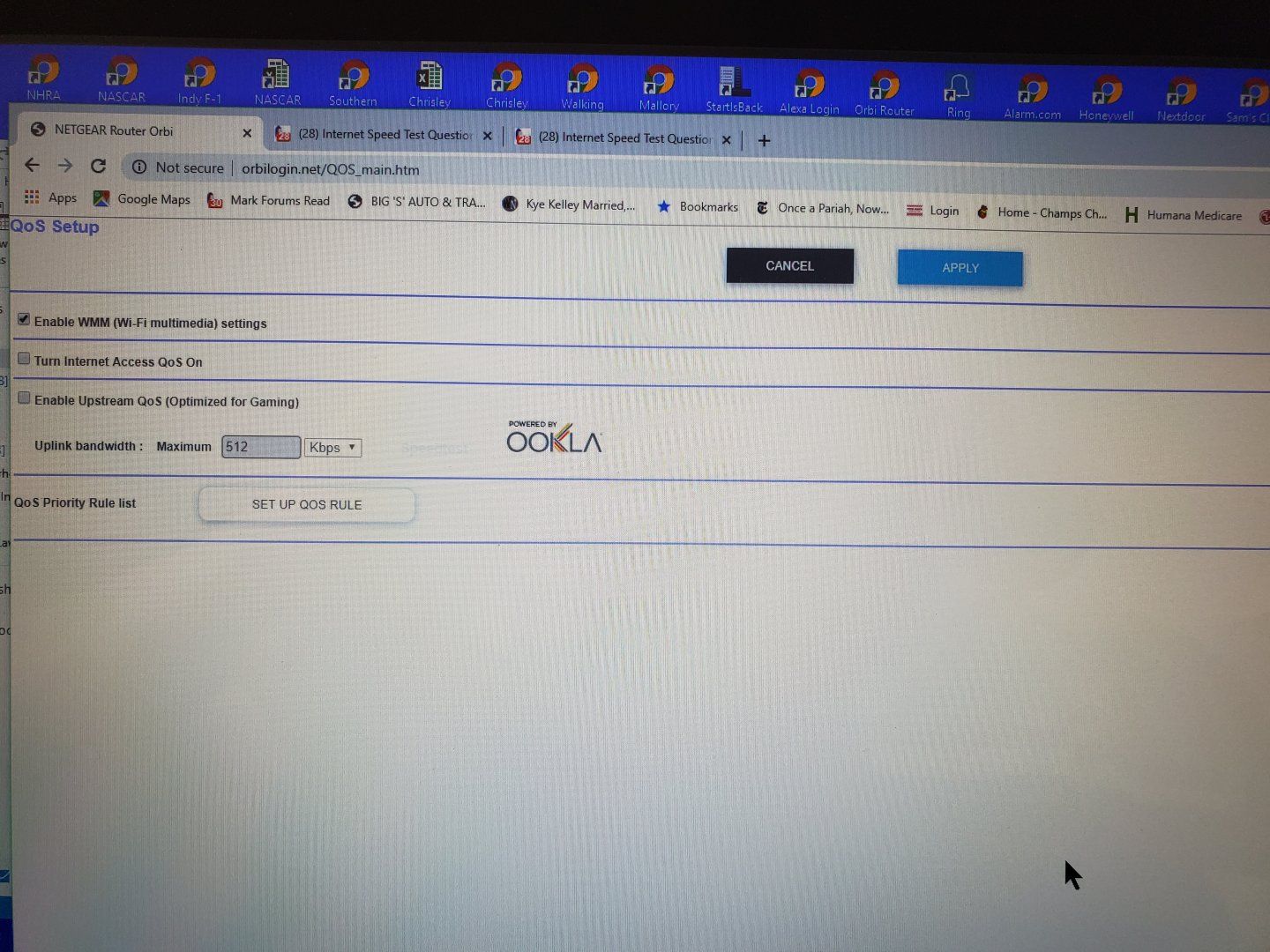

Yes, I clicked on the Advance tab and then QoS Setup. I do not see the WMM page. See attached pic

I typed that in and hit enter. Page left my router and went to a Google search page with info about QoS. I guess my WWM is hidden for some reason.

Try again, somehow a space got in the other link:
Orbi Login
Code:
http://orbilogin.net/QOS_main.htm
If it doesn't work this time, then it must be hidden in your version of firmware.
Sorry, I was outside replacing the blades on my lawn tractor.
Try UNCHECKING the 'Enable WMM', and save (Apply) that. Then see if that makes a difference.
If not, feel free to recheck it again.
