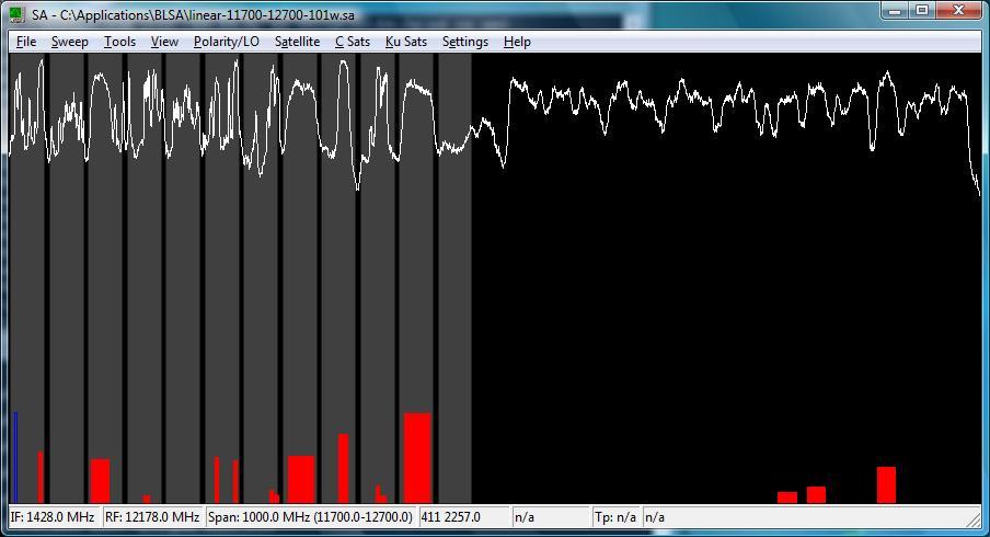

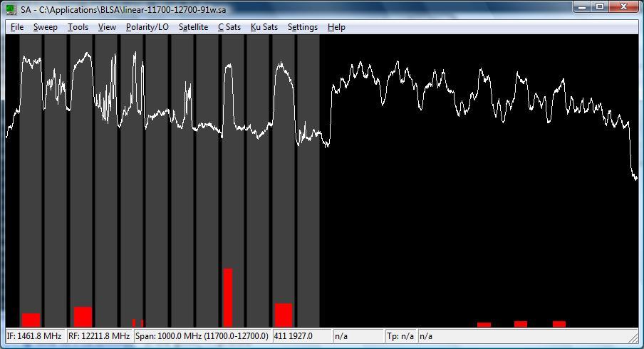

That combo design can't totally reject 12.2-12.7 GHz while you are on 11.7-12.2 GHz range and yes, linear part could get circular signals ( see that Dish thread when 118.75W begin working).
Those side tpns you could see easily if you will use spectrum analyzer ( BLSA will works fine also ).
Yes, the BLSA does work great! :)
See the attached scans on my Invacom's linear port of 91W and 101W respectively.

depending on which receiver you use, it may blind scan in
The Pansat I have scans IF 950-1600 which with a LNB LO of 10750 is 11700-12350. So when I scan a satellite near a DBS one (79, 83, 91, etc) the blind scan does pick up the 1st 7-8 TP's from DBS.
Coolsat doesnt because the frequency scan is from 11700-12200 :)
