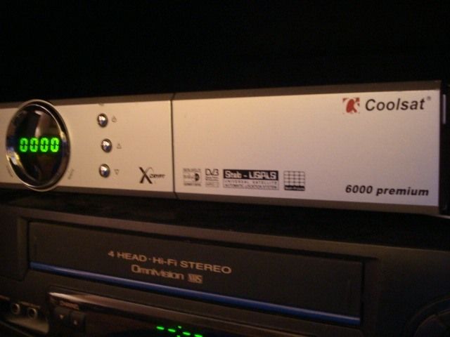

Hey All,
I picked up a Coolsat 6000 today at the Goodwill store. It says 6000 on the front cover and does not seem to have ever been open. Works fine and all but when I went into the "system screen" it says that it is a Coolsat 5000. Like I said works fien and all, but just wondering why? :confused:

Maybe somebody put the wrong firmware on it?
I -think- the only real difference was more memory on the 6000 (and cosmetic)
If you want to load the proper firmware for it, try this third party (non-hack) firmware, which has some of the original bugs repaired:
FTAFirmware for Coolsat
Congratulations on your find (how much was it?)

Anole,
I am quite certain that this would not be possible (loading the 5000 firmware into a 6000 receiver or vice versa). It will give you an error and will not proceed to download to the STB. I cannot recall what the error message is, but it is something along the lines of "incompatible model detected".
My guess would be that someone has swapped the guts from a 5K into the chassis of a 6K. This I believe can be done for the main board and the power supply. I don't think the FPD can be swapped because of the layout design, but I am not certain of that.
Acuevas,
You will know what is really in there if you try to load the firmware for both models. One will load and the other will not. No damage will be done, since it won't allow you to execute the download of the incorrect firmware. You can identify the chassis of the 6K by the round "submarine porthole" surrounding the front panel display, whereas the FPD on the 5K is rectangular. The 6K looks just like the 4K model.

It is just a naming error on the last hack f/w for CS 6000, don't worry about it, should work fine.
AcWxRadar is correct, you cannot load a CS 5000 f/w on to a CS 6000, it won't allow you to! It is pretty idiot proof that way, LOL.

The old rule of thumb was a 6000 is a 5000 (with more EPG memory) in a 4000 box :)

Thanks All,
I downloaded the factory firmware for the 6K and it downloaded just fine. Now the "system screen" says 'Model: Coolsat 6000 Premium'. The unit cost me $4.99 but did not come with remote so I'm using an extra Coolsat 4000 remote that I had handy. ( They have a CaptiveWorks 6000 available too, a bit more expensive and no remote, I bought the 6K since I had a remote I could use. )
I thought to use it as my primary unit and use the 4K as the testing unit. Interesting though the 4K seems to give a better image than does the 6K. The image on the tv screen with the 4K seems more 'rich and livelier' in color. If all the 6K has is more memory and the 4K works just fine I think I'll keep the 4K as the primary unit - pending a few issues that need working out. Too bad the 6K does not do digital OTA.
