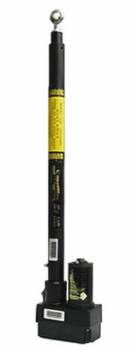

Does it look like this?
That one looks bigger, but generally yeah.
In that 1st ebay auction the zinc plated hardware and whatnot is exactly like what I'm using.
Shawn

I'd say you put way more (well deserved) thought into this than I did. Luckily, mine works. I think the specs weren't quite as critical with my smaller dish. I believe the one I have is the same as the one Cascade has pushing his 1.2M Fortec around now.
The only thing I'd check if I were in your situation is if 18" will be enough travel to swing the dish across your visible arc. I'd give the superjack a shot.
<edit>
In This thread Cascade has a good pic of his actuator. It is the same as mine. This is his pic:
</edit>
Shawn
