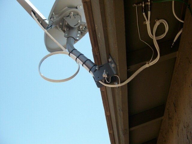

If you know the management has called for using an eaves mount ... then why not just tell dish to include it for the install? make it absolutely clear to them that the installer will need an eaves mount.
you could even be proactive and search for a few types.. contact your property management and request any links, or information for mounts *THEY* recommend, and get approval for the type you're going to use.
Here's an example of one http://skyvision.com/store/mi6000042.html
and with something like *that* you can clearly see it would clear the gutter, clear the roof, and allow a dish to get signal ... there are other eave mount types too ...
The other possibility would be a non penetrating roof mount, *if* your type of roof would work (depends on pitch, standard A type roofs wouldn't work, but if you had a flat roof (pitched for water run off) you could. It uses cinder-blocks to weigh it down.
If the roof of the home is flat and easily accessed, have a non-penetration mount installed from there. Of course, make sure it fits the guidelines of you owning the whole property there, nobody else above or below you. I would suggest having it installed where it is not visible from the street. Even though the HOA has no authority to have it removed, they may still make a fuss if they can see it and it's better to avoid the hassle.
Here's an example of one Skyvision Satellite Equipment
REALLY cool mount. Have never seen one of those.
