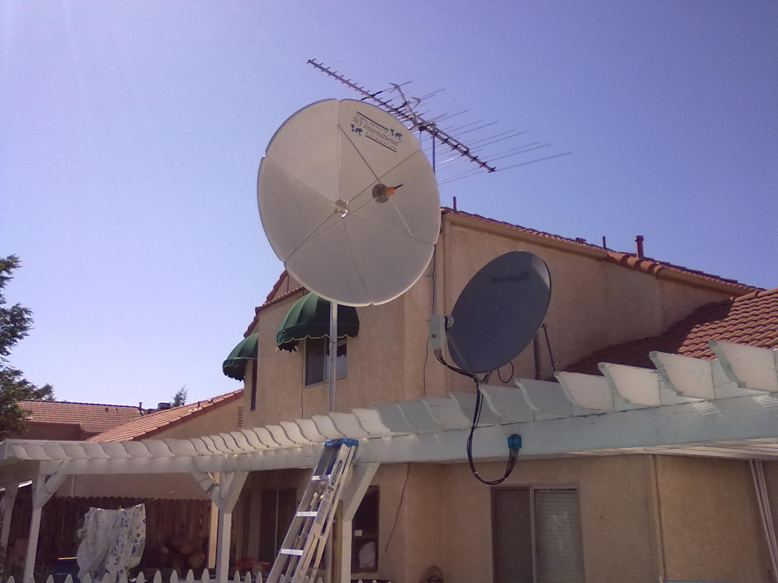

Thought I'd add a picture.
After working all weekend on this, I think I finally got it. I've managed to pick up 121 W through 95 W so far with around an average of 65Q on the C and KU. Some more tweaking of the LNB should make it a little better, but it's a PITA with having to loosen everything to swing the dish around so I can reach the LNB. It was 104 on Friday, 107 on Saturday, 104 on Sunday and it's 11 am and 100 right now. I can't leave my tools out or they burn my hands when I pick them up, so I have to take them up and down with me. I still need to figure out where I'm going to put the V-box, since I don't feel like running another 100 ft of wire and it's only 25 feet from where the receiver will be, I'm thinking of making a storage box for it outside on the wall near the cable and hooking it into the cable out there. So far so good.
