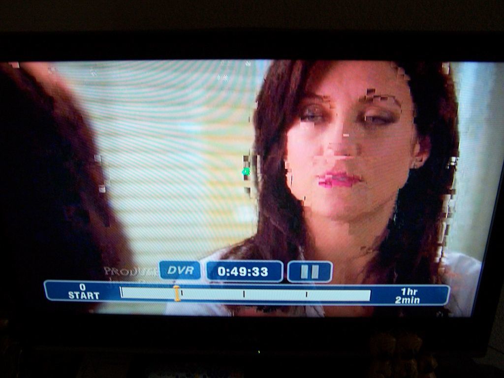

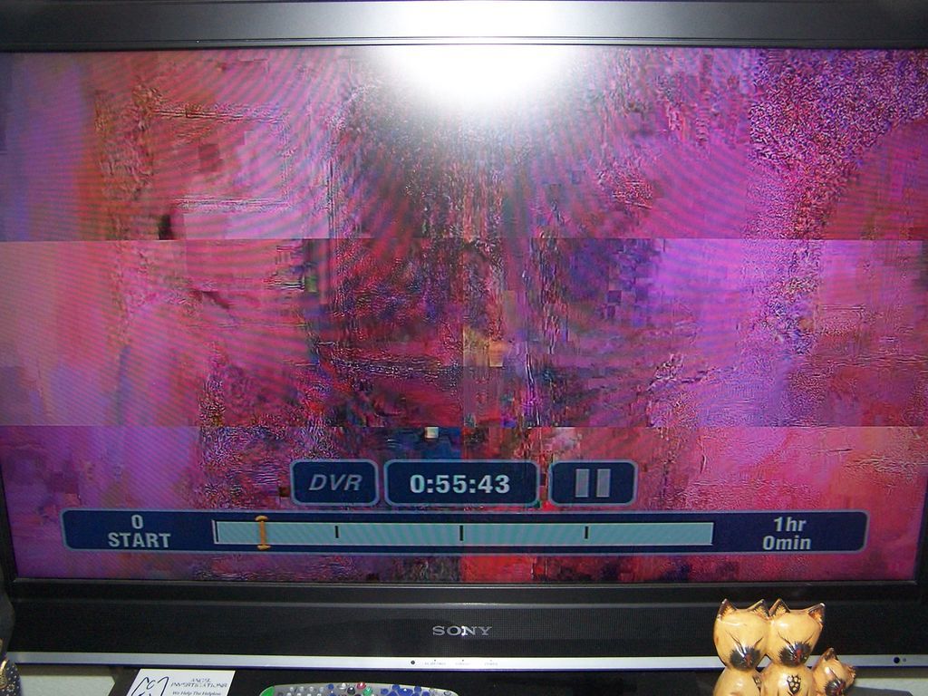

The last three weeks I've been getting un-watchable pink screens and severe macroblocking (sp?) during ABC shows like Lost, Greys Anatomy, Ugly Betty and Desperate Housewives. It only does it on my dish channel, when I switch to the OTA HD feed of ABC I do not encounter the same issues. It doesn't happen over the entire program, but sometimes it lasts for up to five minutes. I called tech support and they treated me like I was crazy, apparently I'm the only one having issues. No other channels are giving me problems, just ABC HD. I've included some pics for examples. Anyone know what is going on? I live in the Seattle area, btw.
Not from your area so I don't know if your ABC station is the culprit, but from the looks of the 2nd attachment your signal levels are very low. You can check by going into the menu. Not sure which receiver you have but on mine you just go to setup / installation / point dish (make sure you're tuned into the ABC channel). You should be at 40 or above.
You are not the only one. There are 2 or 3 recent threads on the same subject, so far most reporting locations are Portland/Seattle. Signal strength has zero to do with it, I have very strong readings get the pixelization and six macroblocks.
The images you snapped are exactly what I've been seeing/experiencing on the same ABC channels for the last three weeks. I live in a marginal OTA area, but I've switched my recordings off Dish and to OTA this week. I'm shocked, SHOCKED, the CSRs didn't know about it.
