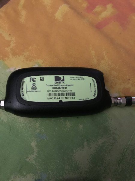

If you had Directv, a 2 way splitter and a decca would get eithernet to your smart tv.
I think you can use that with similar components on dish
I just tried that with my old deca and it won’t make a network connection. I think it’s a different frequency than dish’s moca. D* and dish more than likely not the same. Moca can run on two different frequencies. Therefore they can run side by side possibly. I can’t test that as all I have is half the deca equipment.
But if you have the other half as well(which is basically D* version of the HIC) then you can try it.
