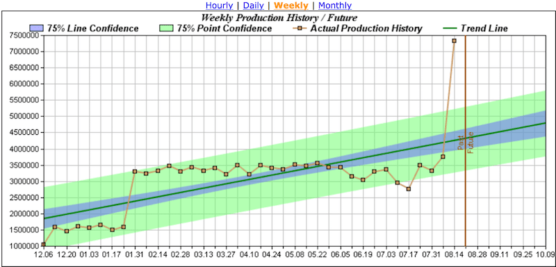

Scott has got to be loving his latest chart. :)
production_day.php
