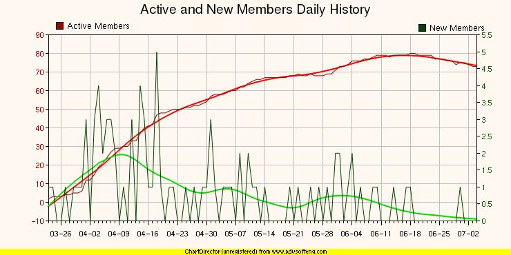

We do need to watch our membership levels; it looks like we peaked a couple of weeks ago and have been losing people since then:
