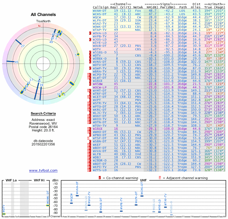

Have you tried entering your exact coordinates (latitude and longitude) into http://www.tvfool.com/index.php?option=com_wrapper&Itemid=29 and seeing what they predict to be available at your location based on strength, terrain, etc? You can also adjust the height of your antenna in their calculator to see different predictions. :)
I've used AntennaWeb before, TVFool appears to show more information, I'll see what I can do with it, thanks

You can also go to the FCC web site and see complete information on every station in the country, including a map showing the coverage area. A station might be omni-directional, with equal signal strength going in all directions, or it might be directional where the signal is stronger in one direction than it is in another, so looking at the map you can see the coverage for the station and see if your city is within the designated coverage area.
Here's the URL: http://transition.fcc.gov/fcc-bin/tvq?call=XXXX where you replace the XXXX with the callsign of the station. You might find several forms shown for the station... their current facility is the one labeled "Licensed". If you see more than one form that shows licensed, check for DT, CA, LP or -D - those are the designators for the main station. DT=Full Power station, CA=Class A station, LP=Low Power station, and -D=translator station. DX is for Auxiliary operation, STA is Special Temporary Authority, etc. Once you select the main form for the station you'll see something like the following:

Please post your TV Foil info if possible.
TVFool info attached!

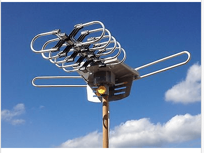

FP-9000 is the antenna, generic, but seems to pick up better than the aerial antenna I had up the other day. And its motorized, so I can rotate while on the DTV(OTA) signal meter on the Dish receiver.
Since both signals are of the same strength, on the same tower (one only two meters higher than the other) that pretty much leaves the distance two different frequencies are able to travel (as Trip said) or the antenna itself. Have you tried adjusting your antenna higher/lower or at different locations around your property?
