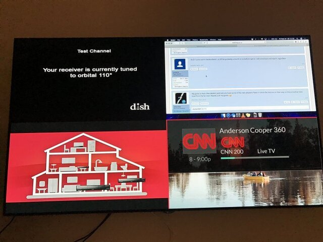

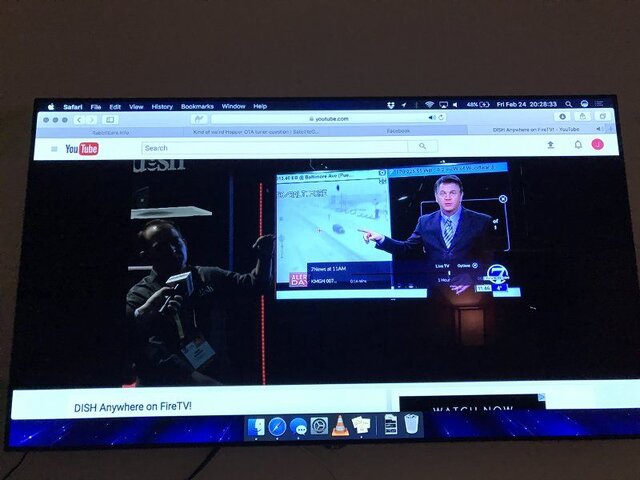

So, I got this in finally this week and it works!

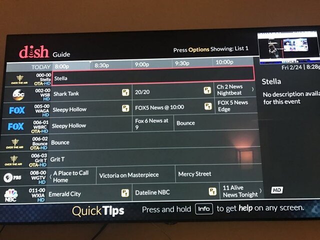

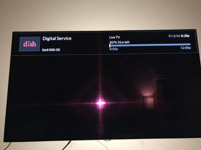

I set the modulator to RF channel 21 and it scanned in just fine. It scans in as channel 00-0. It has a loop through so I can still attach my antenna.
Even though it comes through as channel 00-0, it shows up in the guide and is tunable on the Hopper 3. Just enter three zeros press select and you're there.
Here are some pictures with my laptop connected as a test. The only issue is I'm not getting sound, but that might be an issue with the laptop, I need to test some more sources. Either way for my purposes no sound isn't a huge issue, though I would like to figure it out since this thing cost $300.
