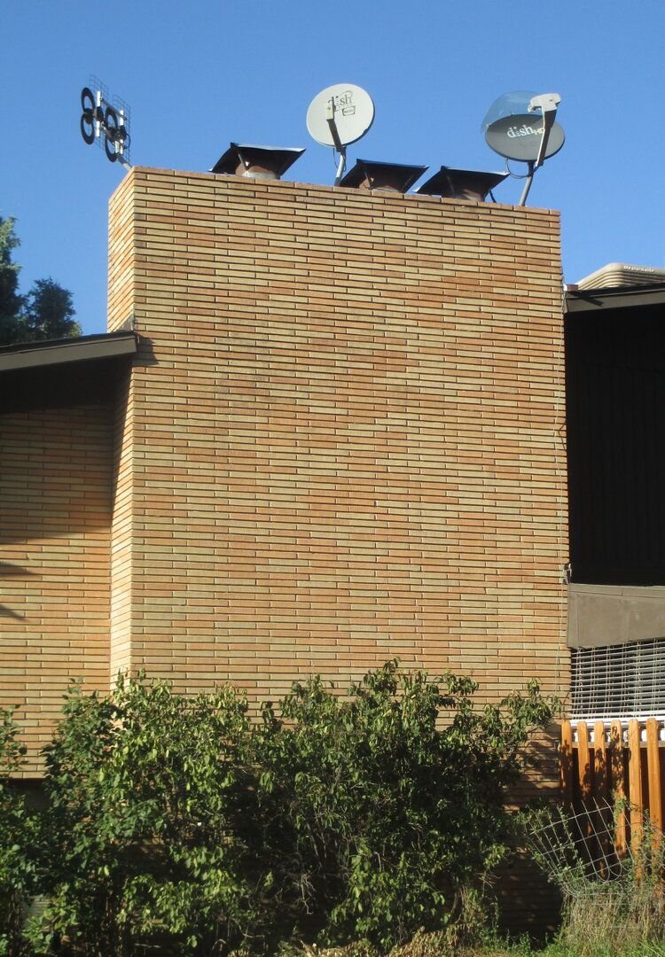

They originally installed it on the facia. When I had a new roof put on I took it off so the roofers could install a proper "Cricket" on the up slope side of the chimney. For the reinstall this is where D¡SH put it. First, the one on the right, then a couple of years later the left. I put up the OTA antenna.
When they installed the two H3s and had to do the DPH44 and whatnot, to get to where that stuff is in the chimney they used a 40 foot ladder. The Installation Training Tech that did the work also wanted to reanchor the dishes. I tried to get him to do it from the roof side where the work surface is waist height. But no. It was 55 year old concrete so it took a while and he said it's in there so good, he'd certify it as an "anchor point".
