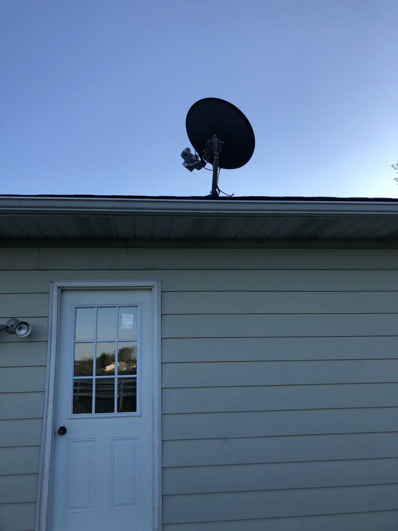

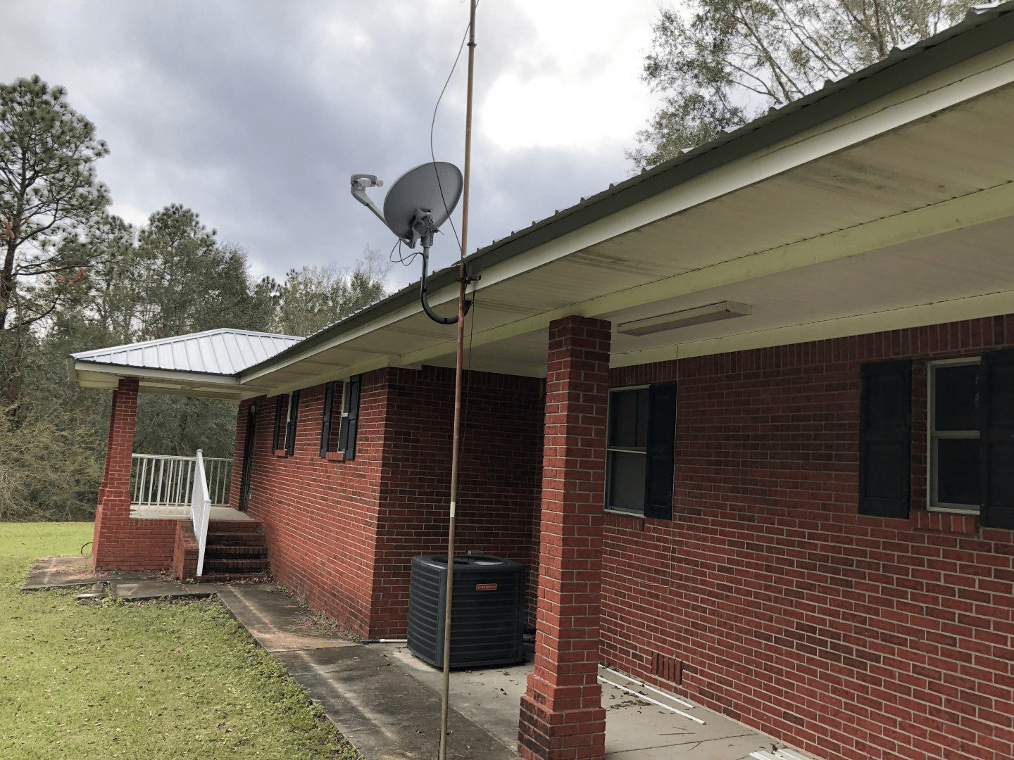

Do you install dish on steel roofs without them leaking!!? The way steel are installed here in pa. They put 1" X 4" furring strips over the shingle roof and the steel is the thickness of the furring strip. So if you mounted a dish on most steel roofs they would surely leak.
Steel roofs are not an authorized mounting option
...So if you mounted a dish on most steel roofs they would surely leak.
Yes. This was my solution.
