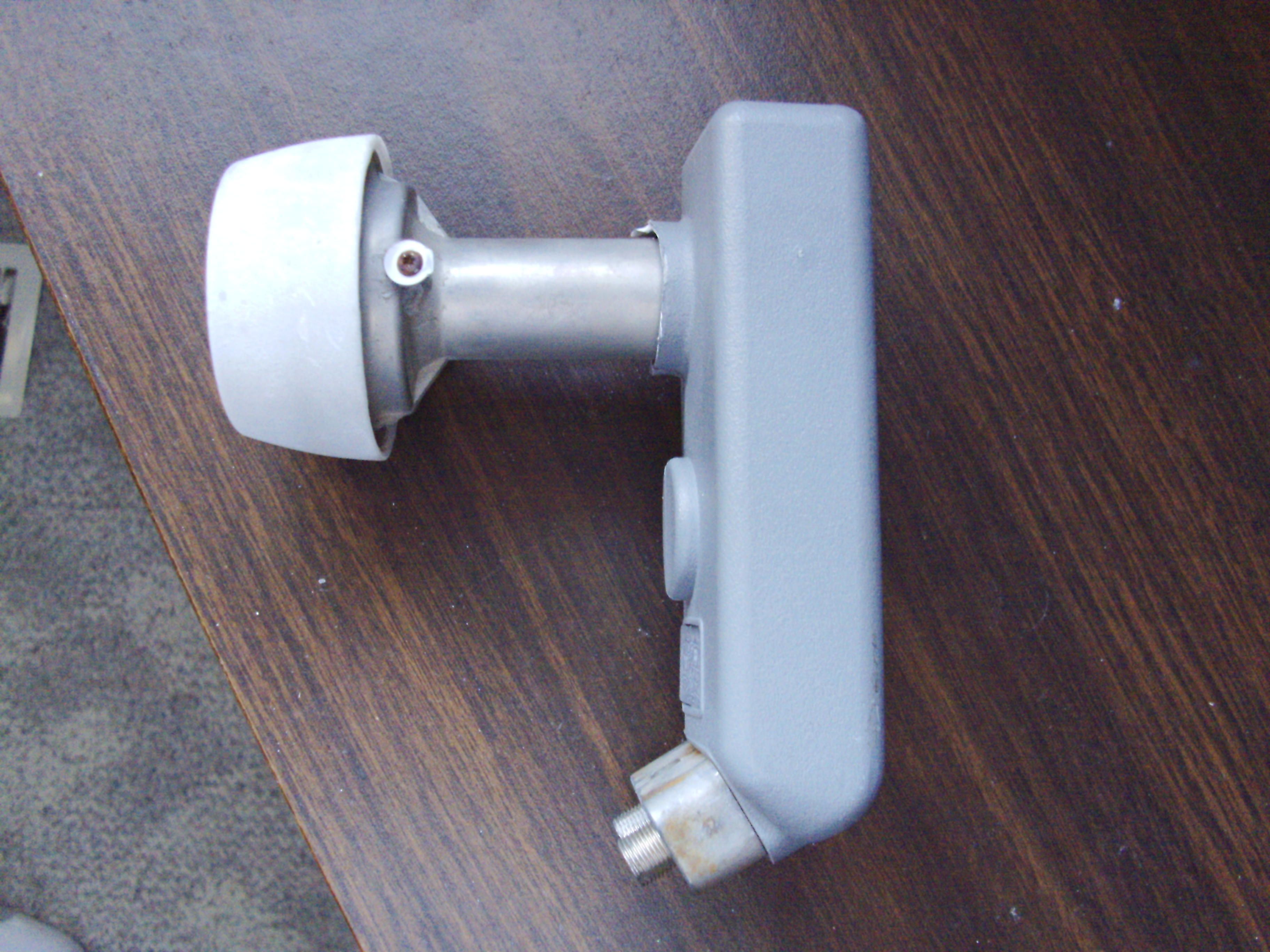

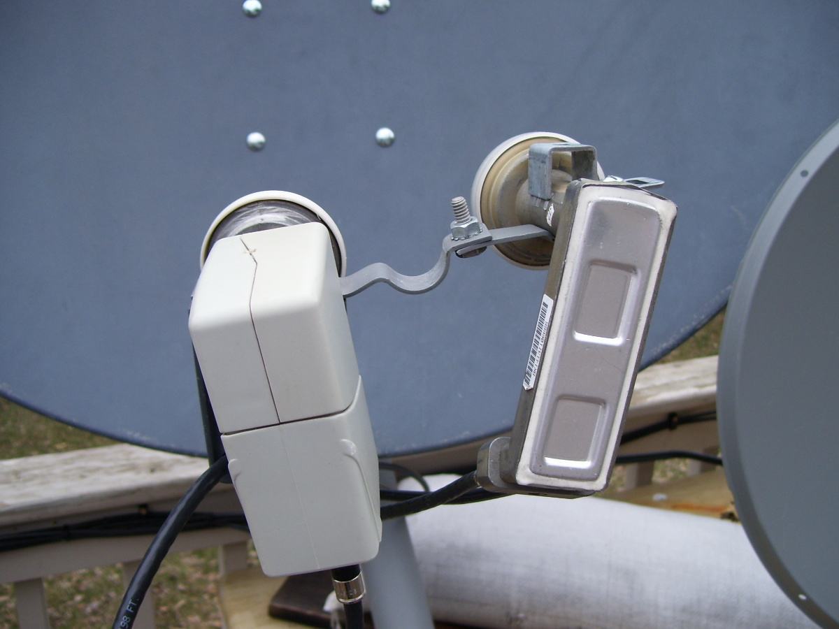

You wouldnt need the "D" type holder
The 36" and larger dishes usually have a 25mm spacer to put in the holder (normal spacing on the holder is 40mm). On the LNB itself you can crack off the plastic casing (doesnt hurt the LNB) and cut part of that plastic off. The naked part of the LNB fits in the 25mm holder just fine
(2nd pic is one of a naked LNB that worked just fine)
