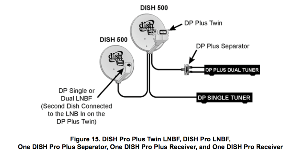

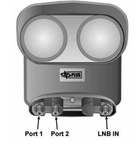

I'm putting together a Dish 500 Pro dish for RVing. The twin LNBF unit has two LNBF outputs on the 119 side and one LNBF IN on the 110 side. This unit is not included in the Installation Instruction booklet.
What's the LNBF IN used for?
Turn on the receiver. go to menu. Go to install. Go to point dish. set for Dish 500, that should give you the elevation, azimuth, and skew needed to find the sat. Adjust your dish to those readings and listen for the tone (Its a higher pitch) on the receiver to tell you when you hit the sat. You probalbly need to make minor adjustments to get the best signal and you must be level to get the correct elevation. The first time I tried it I had trouble finding 119. Locating 110 was easier, so all you need to do after that is move the dish right (west) til it picks up 119.
Thanks much! That pdf is much better than the instruction booklet that came with mine because it's the one I've actually got. Better still since our new Akita puppy shredded the original booklet. :mad:

Thanks to all, and especially to phpinfo for the pdf file. My original install booklet wasn't for the specific LNBs that I had. I needed a separator in order to power the LNBs. I set the dish outside pointed in the general direction of the sat. I went in to turn up the sound for aiming and the sats had already locked and were GTG. :cool:
Thanks again!
