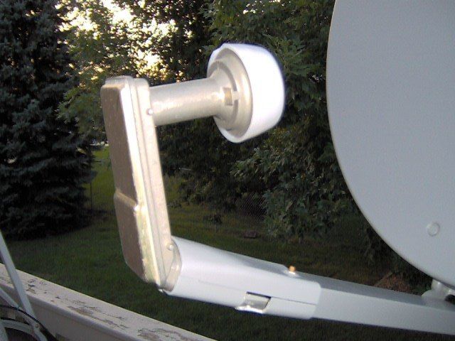

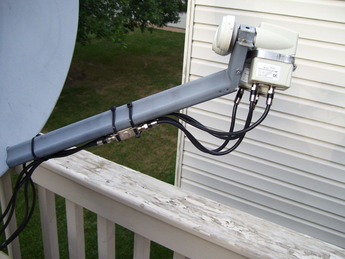

Why would it have to be a D shaped? Most larger dishes (60cm/76cm) have a 25mm holder that you can just crack the case off the LNB and it will fit just fine. Done that numerous times
I was wanting to have 129 on a separate dish due to trees being in the way where my current Dish 500+ is mounted, the idea was to move 129 to the roof where I can get signal as opposed to having 129 on the 500+ which comes in and out as the tree branches move in the wind, and as for the 60cm dish, thats just to maximize on signal and avoid as much rain fade as possible
but again why not get a larger dish (like 76cm as example) that is readily available and use that instead? Have a LNB for 129 and just gut the casing. Like I say I've dont it numerous times and it still works fine.
Here is an example I did on an old Primestar dish. The little "dip" where the LNB goes in is 25mm. So I cracked the casing behind the LNB eye and fit it in the slot.
and the 2nd pic is what a gutted LNB looks like
I see what you mean, Yeah that could work, the other idea I had was to repurpose my super dish lnb and just use the 119 side for hitting 129 because again a mount could also be made for it, by the way thanks for the pictures and info :)
I plan to go with Iceberg's suggestion as I have all the parts needed to complete the job (just didn't think to configure it in this manor) I think its over kill now to order the dish when I have the parts, but only question is the plastic lip on top of the lnb, What purpose does it serve? Is it just to keep water off, and if it doesn't have the lip will it be ok? (I know the old 18inch direct tv dishses had the LNB without this lip (or am I overacting and should just complete the project) :)
