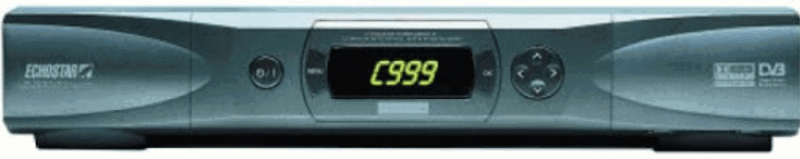

Since we have the lock down in the UK I thought I would fire up my old sat system but its very clear many things have changed , About 30 years ago I had a large motorised sat system installed the receiver was a Echostar ad 3600ip this would run my 36 inch jack and my Ku/C band Chaparral Corotor . My problem is this the Echostar is only good for MPEG-2 the problem is now days that most use MPEG-4 so I need to replace the receiver .But its not as straight forward as that as I have a 36 inch Jack and a Chaparral Corotor with Skew to control . The feed back I have been getting is keep the Echostar to drive the jack and skew and just buy a separate receiver this sounds ok but I would have to keep switching from one screen to the other on the TV thats going to be a pain .
Or
Buy a ADC1 for Jack and Skew and use a new Sat receiver for MPEG-4 .
Or
Find a replacement sat receiver that does MPEG-4 and has got jack control and skew control there maybe not much of a demand in the UK but there are millions of motorised sat system all over the world and I dont think there using 2 boxes one fpr receiver and one for Jack + Skew .
If I get no joy I will have a chat with Echostar assuming there still in Holland .
Many Thanks

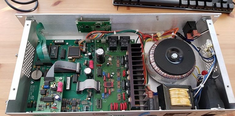

Looking at the manual for the Reseach Concepts Rc 1500 I got the impression that it doesn't work with diseqc commands?
Reactions: FTA4PA
i've used the RC-2000A about 25 years ago. Great positioner for tracking inclided-orbit satellites, built like a tank, but not really suited to home use. No Diseqc control, no remote...

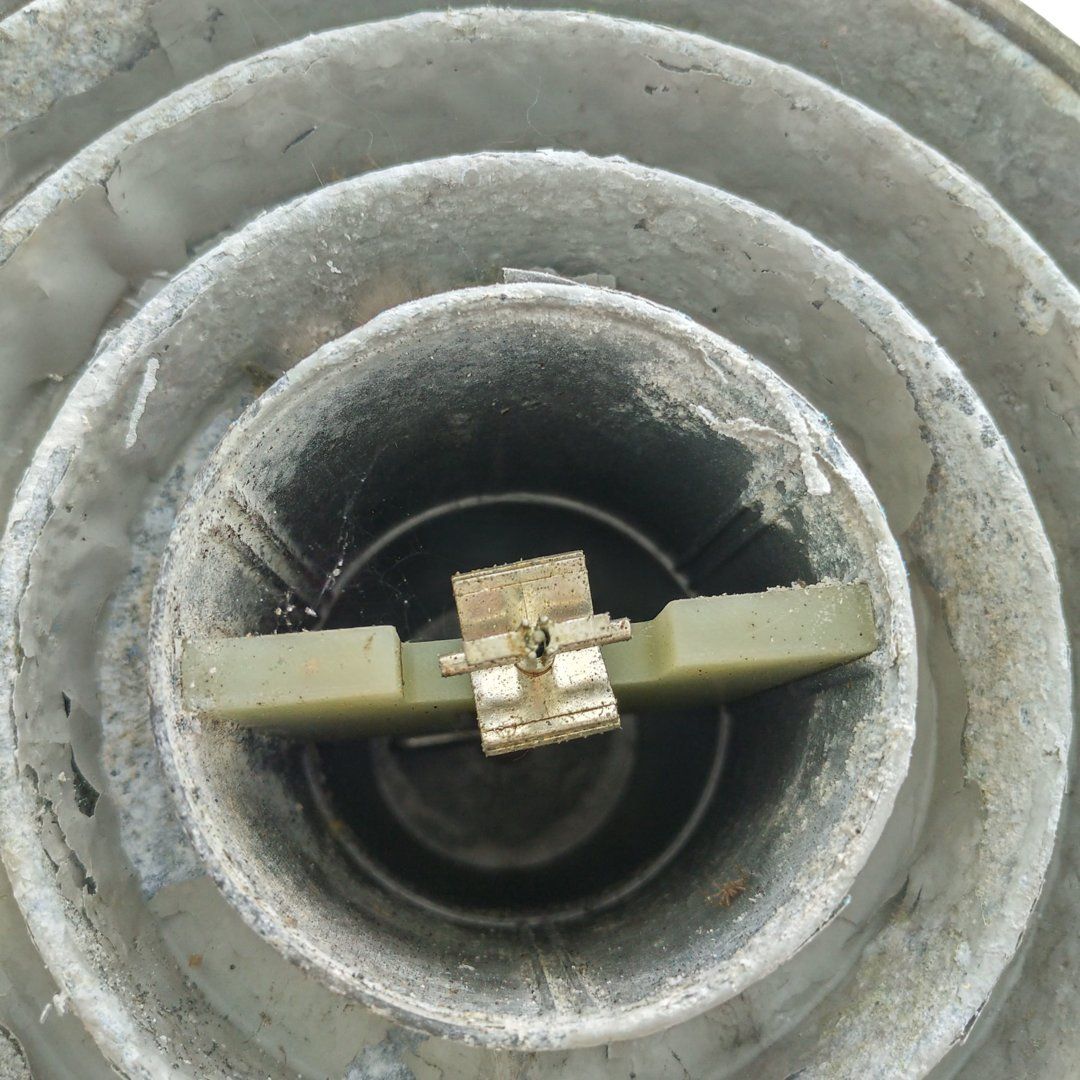

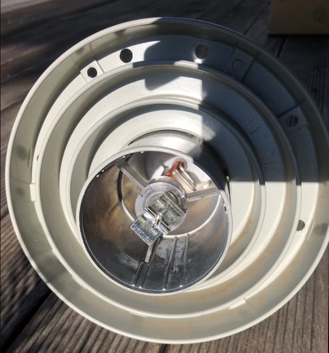

Many Thanks for the feed back guys well the update from this end is I did buy a TM-5402 as for my dish I have now got 3 new support arms that need to be fitted while that off I think I will change out the corotor as the skew motor no longer works I have check and to can turn it by hand so I can only assume the motor has gone down since its been up for over 30 years the corrosion is very bad on the neck and scalar ring . I have bought a replacement so I will change out the whole thing . Which brings me to the LNBs Been looking to replace the LNB with a
SMW Ku-Band Quad Multiband LNB (switchable) Q-PLL Type Ror Type E but finding it very hard to find one and the ones that are available they are asking silly money for since one is 9 + the other 11 years old and there looking form £480 - £519 pounds found a few states side but by the time you pay import duty its not worth it as for buying from SMW that only deal with trade however they would sell me a Type R for £850 so we shall see .
Which bring me to Jack + Skew control at the moment I am using the old Echostar for Jack and Skew control as getting so much bad feed back regarding the ASC1 regarding the PSU not coping with a large Jack and Dish . But from looking at your comments regarding Reseach Concepts single and dual axis controller thats not going to be suitable since no
Diseqc 1.2 so looks like the only option will be the ASC1 or keep using the Echostar .
So the fun and games will start when I start trying to remove the old support arms nuts that have been there for over 30 years I will try WD40 and if all else fails cut the nuts off with the dremel . Thanks again for all the feed back as I was not aware that the R/C controller was not suitable .

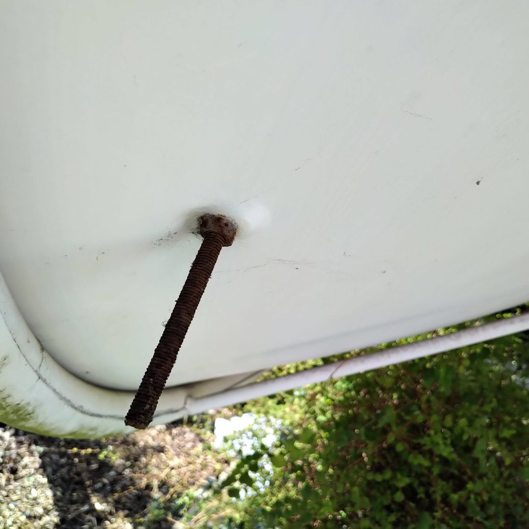

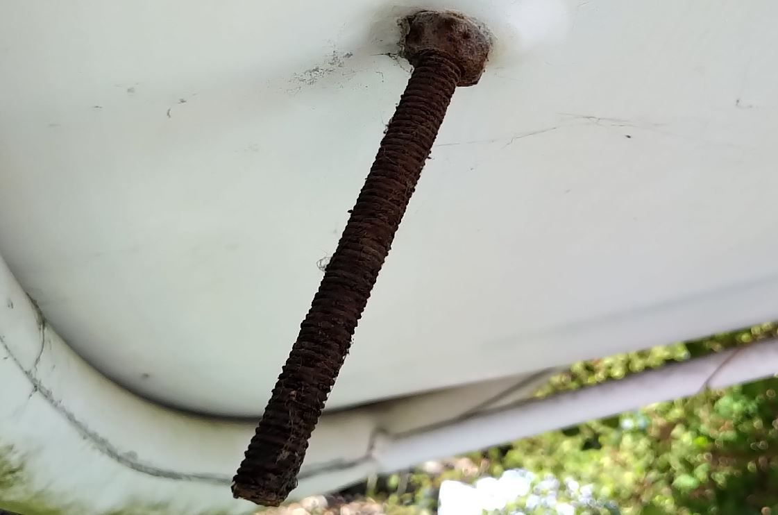

73

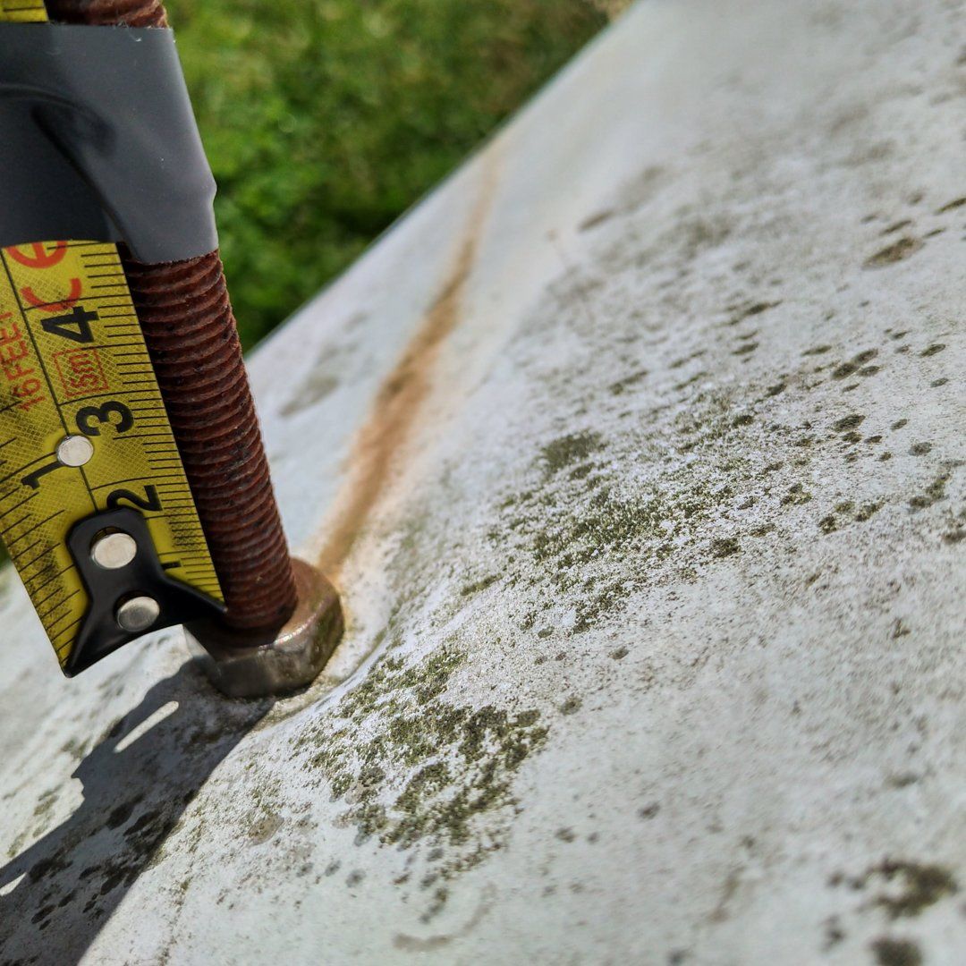

Not sure what is available on your side of the pond but some kind of rust penetrant ( I use PB Blaster) is a must. Soak it for several days and reapply daily. Does wonders to free up things that you would swear will never come apart. Good luck! :)
Hi FTA4PA Thanks for the feed back yes I think one of the other guys did say that there was some other oil that I could try over in the UK we have WD40 or if say working on a engine you can use heat but this is a 3.7m spun aluminium dish so cant use heat so its going to be a hacksaw job cutting across the nut , Use the dremel with a small cutting wheel or a nut splitter these nuts have been on these rods for over 30 years so there going to fight all the way .We cant buy stuff from the US due to the high import duty which is 25% mad as it sounds

I've used both WD40 and PB Blaster and the latter is definitely superior in my opinion. No experience with this product but it apparently is available in the UK.
I've never used it but have used other Lucas products and was pleased with their quality so worth a try if PB Blaster is not available. :)
Thanks FTA4PA I will drop them a email and find out if there is any local dealers in my area or maybe I can find some on ebay or amazon , My local Halfords is open I can check there but I have a large can of WD40 so the nuts will be removed or cut off but I will wait until the corotor arrives .

Good old DOT 3 brake fluid is a great penetrant. But it will screw up paint.
Any decent rust penetrant will work. Tapping the hardware with a hammer and buck bar will help it sink in.

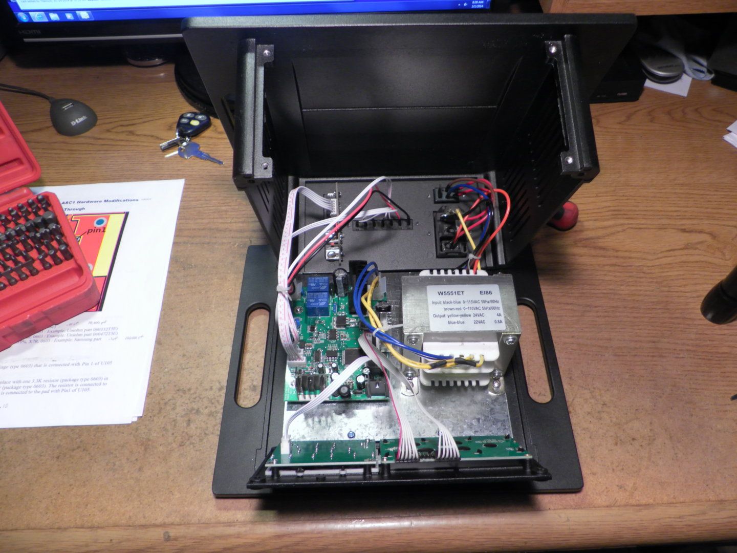

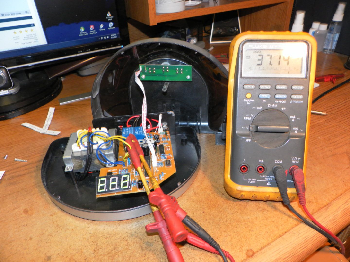

I have no issues with my ASC-1 driving a 12 foot fiberglass dish even at -10 f.
Your actuator has to work smoothly. Gooked-up grease wont help that.
A worn or weathered motor might benefit from a cleaning and lube.
Drill a hole bottom center of the actuator just big enough to thread in a Zerk 2 or so turns and pump in some good low temp grease if you don't want to take it apart.
Thanks Guys for the feed back on the ASC1 yes the amount of feed back I have had regarding the PSU and that it requires mods my jack is a 36 inch 36 volt Thomson Saginaw Actuator with Hall Effect Sensor it works fine with the Echostar Ad-3000IP but it would seem that the Reseach Concepts single and dual axis controller thats not going to be suitable since no Diseqc 1.2 so my only option is the ASC1 or use the Echostar . The Dish is a 3.7 spun aluminium .

$1500 and no DiSEqC, I guess you do ;)
yes, but we were comparing transformers at this point. :)
If you want to move a large dish with little or no interruption, current handling capabilities is important.
(Total aggregate user experience is a different thing... As Brct203 says above, "not really suited to home use. No Diseqc control, no remote...")
