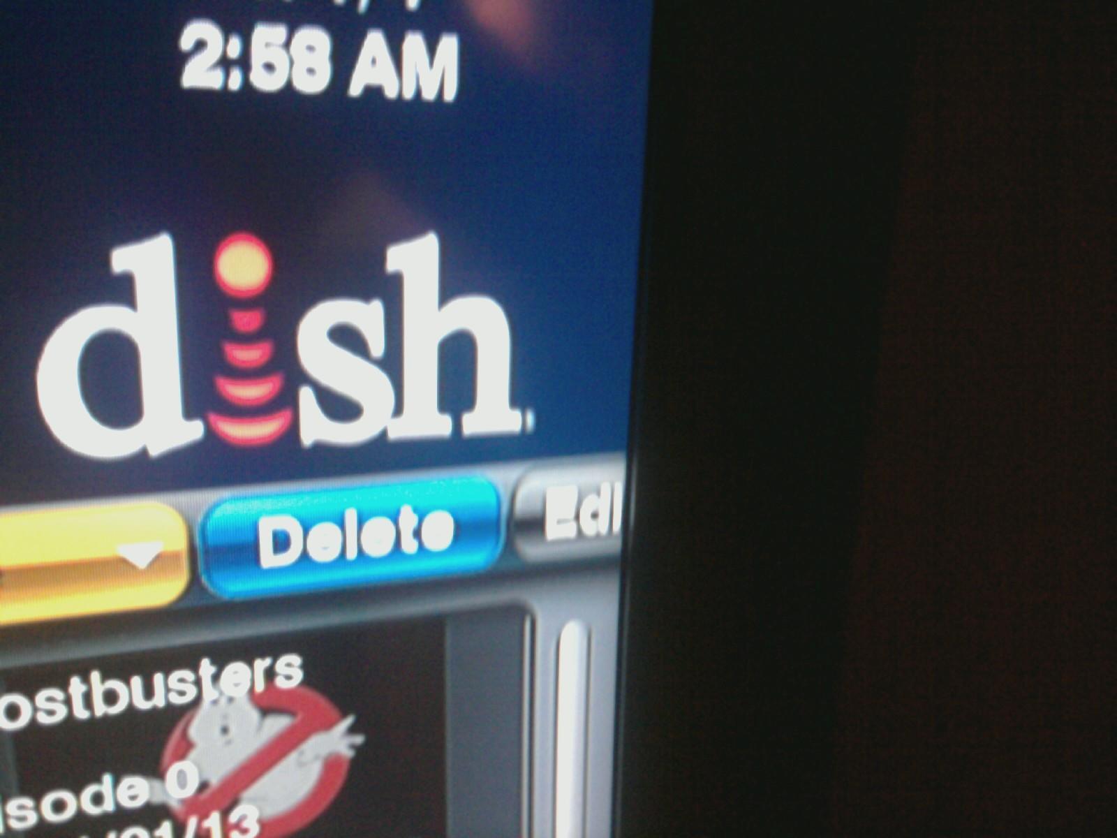

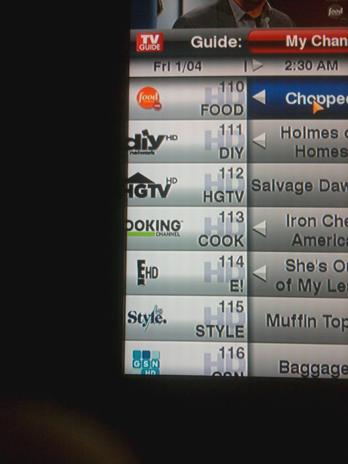

Hello all i listed some pictures below of the problems i seen with the on Screen Guide. Just does not seem to fit right to me on left hand side were logos are at alot of them or cut off only show half and the bottom part its a little bit cut off also the far right hand side is as well. Any one else have the same problem

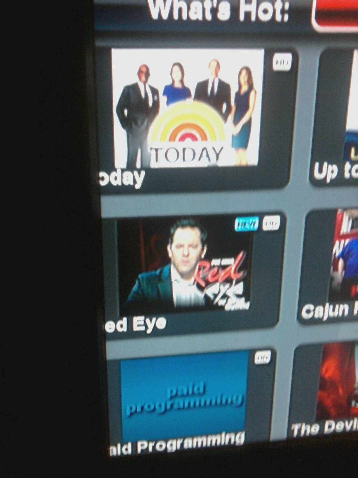

The whats Hot Menu same issue far left side some of its messing as the pictures below. im the only

press yellow, 7, 2 then make the necesary adjustments so the guide fits your screen.
I had the same issue but using the screen adjustment worked for me. What kind of TV do you have? Is it an older tube TV?
I had to put my TV on "screen fit" to get the guide to fit properly.
-Ted
One thing is I wish is that the increments the screen moves and increases and decreases in size would be about half of what they are now. It would allow for more precise adjustment.
