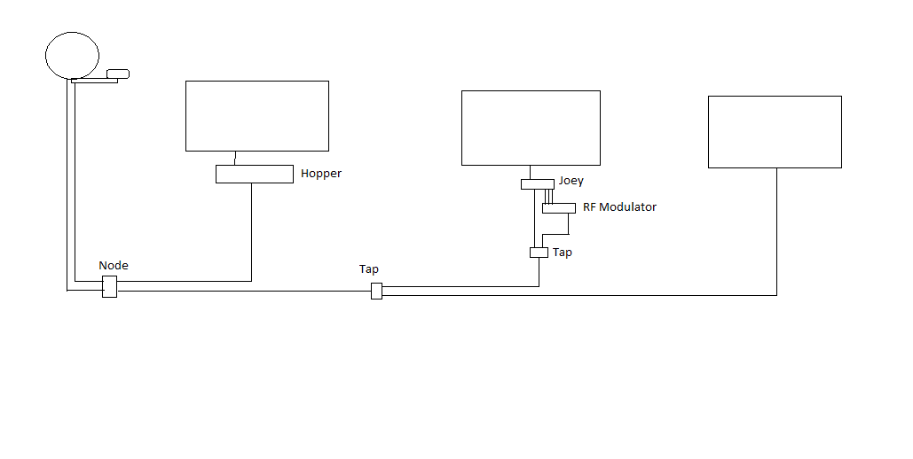

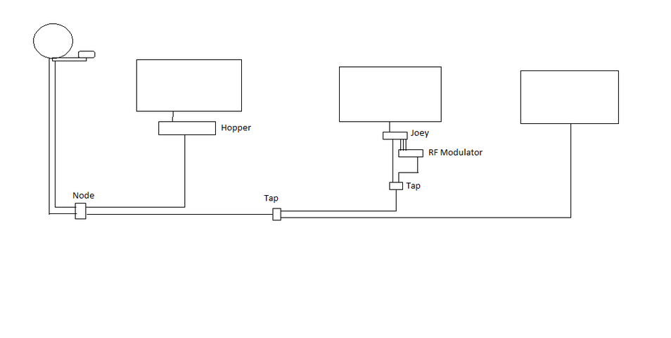

This is what we did
We just worked on this some more and found out some interesting things. We were able to replace the Taps with high frequency splitters and it continued to work. We also took out the amplifier and RF modulator and replaced it with a micro modulator. By doing this we were able to change the channel output to channel 73 and that cleared up the picture drastically. After we cleaned up the picture quality we ran it through out distribution box and had a pretty good looking picture on all the TVs in out TV room.
So with the addition of the micro modulator and two Taps you can mirror a Joey just like you use to mirror off of a dual tuner using just a single coax. The modulator we used was a Holland HMM-10H Commercial Grade Micro Modulator. It was one we had in stock and they sell for around $60-70. There may be cheaper ones available on the market.
