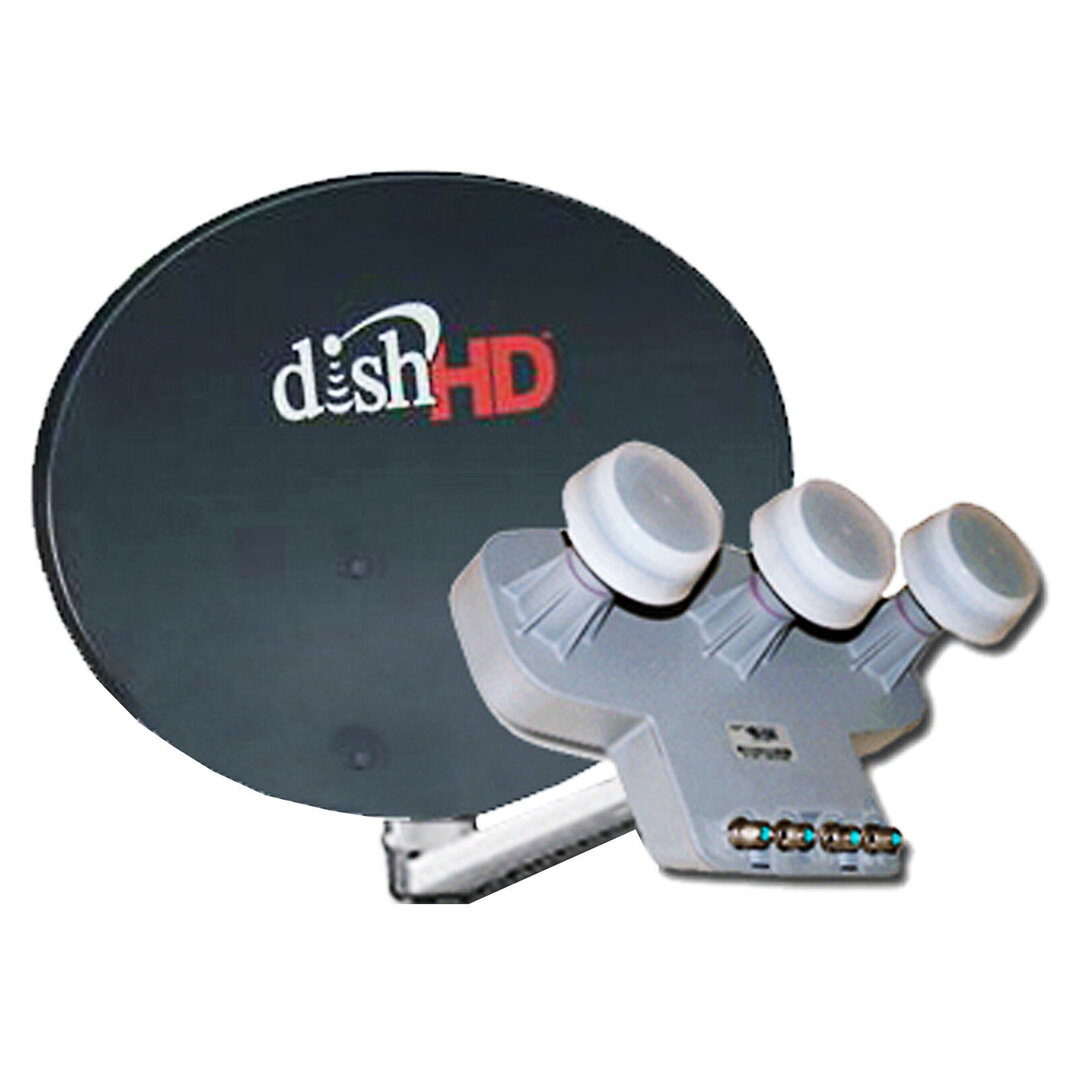

Thanks for providing your setup - since you only have 119 and 110 is the issue. A bunch of the music channels were moved to the 129 satellite last week, so that is why they disappeared. I was looking at this over the weekend a mixture of the DISH music channels as well as the Sirius XM music channels that moved.
Thank you all, especially (((frog))).... So is this a forced hand to have to get a joey or hopper? Or. How to get 129 please?
You get a dish that picks up 3 satellites

I had thought of that too. . just did another chat and got a manager, this time at least that's what he said, and he said that I had a three band in their records, not a two band and I was supposed to get a letter two weeks ago that said that this change would be going through (dish never does that) lol
I get a new remote today free also because I've been with them almost 25 years and the guy is going to be here at noon . no charge and....a credit for a months payment. Wowwww
so all well that ends well with my fingers crossed .
