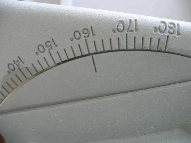

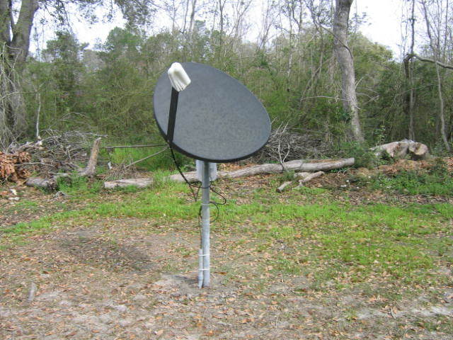

I finally got around to taking pics of the skew...
I see why the skew is really wacky. You have it off by 90 degrees. The way it shows in the picture would be if you were aiming at G10 which is to the west of you.
With it set normally it should work at 70 skew or so :)
But if it works fine, you may not want to change it

it does look weird in the picture but it doesn't hurt to try it the other way. Or maybe the LNB might be off by 90 degrees? Can the LNB be twisted too?
The LNB is installed straight up. I lined it up to zero. The dish, well, I just put it on the ONN transponder and skewed the dish both ways until I had the best signal. Where it is right now is the best I got. I have no idea why, Like y'all said maybe I am 90 degrees off...but it works danged good like it is so I am leaving it.:up
