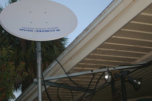

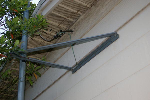

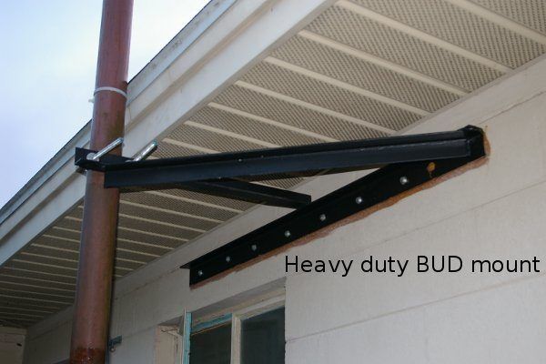

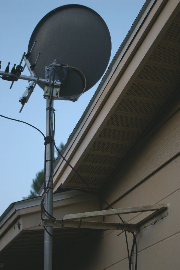

Hi, if the edge of the roof that you want to mount near faces south then consider using the stand off pipe mount. It is simply a long pipe stuck in concrete at the bottom and running just outside of the roof edge and mounted to the wall just under the roof using angle steel. This simple design is very strong and stable and can be scaled to work with just about any size dish. I have my 10 foot BUD mounted this way.
You may also be able to get it to work if the roof edge faces west or east but you would need to check LOS over the roof.
For a 1.2 meter dish you might try and find some 2 3/8 inch fence post. There is a fence supply store here in central Florida that will sell the post uncut at 20 feet long. You should be able to find the same in other large cities.
I will try to take some sample pictures, DC
Edit --- here are some pictures:

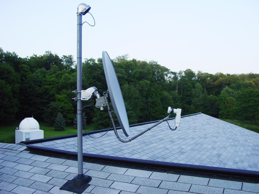

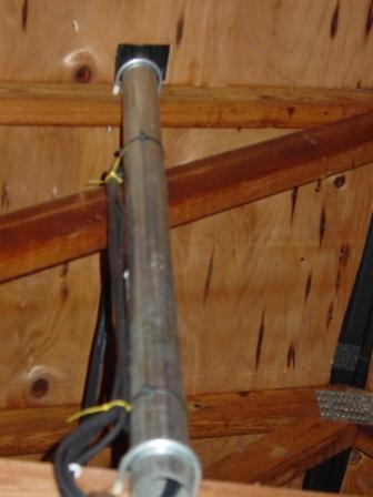

My preferred solution for roof mounting utilizes a vent sleeve. They are typically used to weatherproof roof penetrations for sewer vents.
Here are two views of the same installation - one as seen from above the roof, and one from below:

Hi GrumpyGuy and the group, I really like your system for mounting the dish. I see it being very useful for people that have steep roofs and a real attic with access. The use of the standard roof vent sleeve would allow roof repair and even replacement without affecting the dish alignment and the roof workers would be familiar with it. The use of the electrical fitting at the top and the running of the cable inside makes for a very clean install.
Thumbs up! DC
