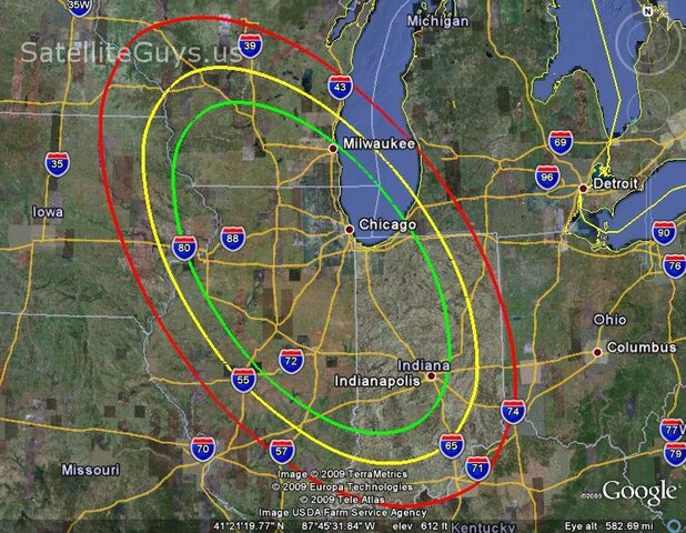

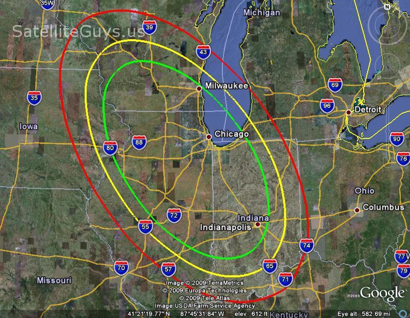

This is the spotbeam footprint for the Green Bay HD locals off E12 spotbeam 11 from 61.5. As you can see, the UP is not even on this map! You can try aiming a D300 to 61.5 and see what you get. I'd say not likely, but you never know for sure without trying.

He's already getting the WA with the 1000.2 dish, the 1000.4 WA will change nothing. The HD locals are coming from EA and they need the 1000.4 EA dish, which is why he was told he needs the 1000.4 dish.
You have to know where the spot beams are shining, and which spotbeams you need before you move. In this case, the OP may have moved out of the "light"
