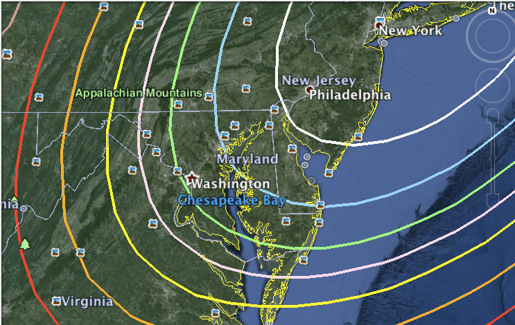

I have been looking and trying to figure out if its possible to pick up HD NYC locals in he 21673 zip code of MD. One of the maps I found shows the spot beam of the NYC locals I am just outside the blue line. First is the white line that extends to south Jersey then the second line is blue which reaches almost to southern Delaware. I am just west of that outside the blue line between the o in Washington and e in Chesapeake. I am wondering if I move to the NYC DMA if I would be able to receive the locals in this location? Or is there a better way to figure this out?

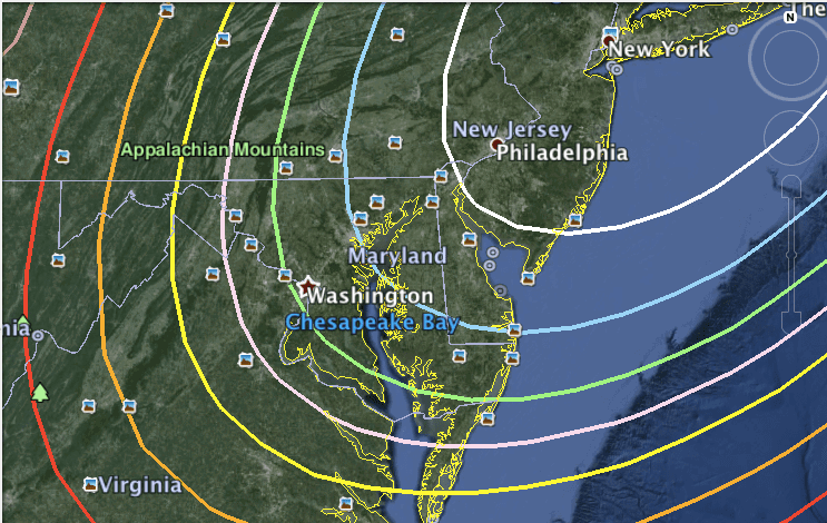

The MAJOR NY Locals are on Conus, so they are available everywhere, same as LA.
Getting authorization is the issue.
The Non Major locals would be the ones in question due to the spot beams.

The NYC locals that aren't on CONUS beams are on 99s transponders 16 and 20, also on 103s transponder 17. Check your signal strength on those transponders. If your signal strengths are at least in the 70s, you are probably good to go. Anything lower than that and you will likely have issues on rainy days.

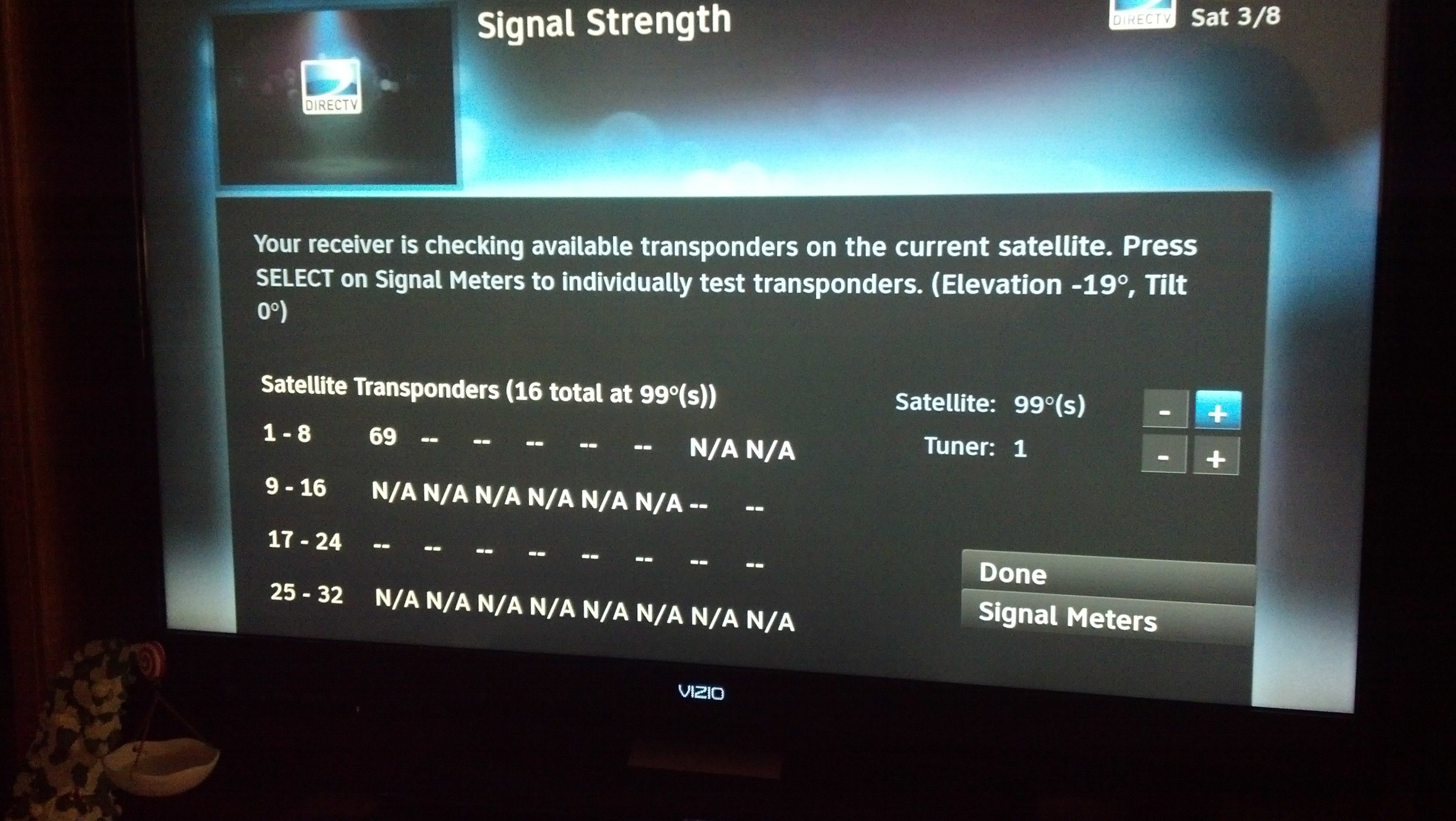

I haven't used Direct TV but just watched a video on how to check the signal. Just to make sure, I would have them go into system setup, then satellite, then signal strength. Have them choose satellite 99 and look at the strength for 16 and 20 and then choose satellite 103 and look at the strength for 17? That sounds simple enough I think I could walk them through it without going over.

Thanks. That was my next question. They sent me some pictures and some had the s, c, etc. They did send one for 99s but I don't see one for 103s (I will have to ask for one) but here is the one for 99s which shows N/A or -- for all but 1. I am assuming that means I won't pick them up?

Actually, 2 things might be happening here..
1) they need thier dish re pointed, fine tuned, as they should have something on the 99s ... unless and this may be what happened, is the (s) Sats take longer to pop in to give you numbers, for example, I am checking mine now and it takes about a minute or two for the numbers to populate.
They probably just looked at it quickly without waiting (didn't know to wait, ya know), I would have them check it again for you.
Or the 2nd thing may be that your locals are on the 103s instead, that said, you should still have something in the designated fields, weather its a 0, or a N/A or a 98 for example.
When looking at the populated screen, it is common to find only 1 or 2 transponders really high, that would be the ones feeding your area, while the lower numbers feed other areas.
